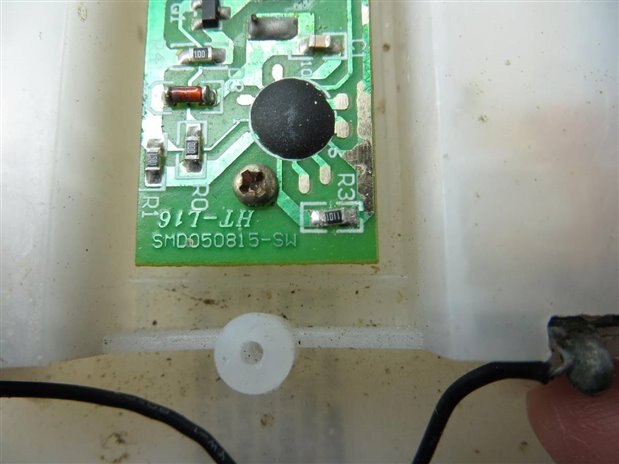

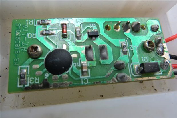

I can't find a local source for a SMR that somehow got knocked off an outdoor solar lantern's PCB while I was trying to refurbish it.  Thankfully I had another device and could look to see which one it was.  But I can't figure out what to order online.  I took both devices to a well-known local electronics store, but the tech at the counter looked at the intact one with a magnifying glass but couldn't tell me which SMR I needed either.
The numbers on it are either 1101 or 1011.  I can't tell which direction to read it, and am no electronics expert by any means.  Attached are photos of the intact and functional PCB.  The SMR I need another of is in position R3.  Can anyone advise me which one of many offered by Element 14's catalog is correct?

    mcb1 over 11 years ago in reply to hafcanadian +2
    I take it that it doesn't matter in this application what the resistor's specifications are, such as milliwatts, voltage, case style? In this application probably not... EXCEPT the case style needs…

    It is either a 1.1k or a 1.01k and I would think either would work in your circuit Regards
    mcb1 over 11 years ago in reply to Robert Peter Oakes +1 suggested
    You should also be able to measure it. If you really wanted, a small cut on the track below or right of the silkscreen R3 would isolate it. The cut is easy to fix with some solder. Mark

    Thanks Peter and Paul.  Those aren't unsoldered terminals;  the two at each end are guide pins at either end of a slide switch housing on the other side of the board.  Two in the middle are contact pins for "ON" and the third unsoldered one is for the "OFF" position contact.
    The only shuddering necessary is if you were to see my earlier greenhorn soldering attempts on the other PCB that has the missing surface mount resistor.  When I get a new SMR for it, I'll try to use my new Hakko iron, 65/35 solder, flux pen and flux remover pen, and hopefully better technique to clean that mess up.  With age has come a tremor that makes fine-circuit soldering particularly difficult, even with "helping hands"/magnifier, so results aren't always as pretty as I'd like.
    I guess I'll go for one of the "1101" resistors in Newark's catalog.  I take it that it doesn't matter in this application what the resistor's specifications are, such as milliwatts, voltage, case style?   http://www.newark.com/webapp/wcs/stores/servlet/Search?catalogId=15003&langId=-1&storeId=10194&gs=true&st=surface%20mount%20resistor%201101
    In this application probably not... EXCEPT the case style needs to match the spacing of the pads.
    Try this link to work out which one
    http://www.resistorguide.com/resistor-sizes-and-packages/

    Say, that was quite helpful, Mark.  Thanks.  I could finally interpret the numbers on the SMD, although it would still be good to know which direction to read them;  the "1's" don't have tails on their font style, so I can't tell which way is up.  Weird, since some of the other SMD's on the board use a more intelligible font, with tails on their "1's".  Regardless, it deciphers to either an 1100 or a 1010 ohm resistor.  Hopefully the 90 ohm difference isn't significant in this application.  The calculator on one page of the resistorguide link you provided was a cool tool, although by then I'd already calculated the resistance values myself from the text and confirmed them via the video they provided.
    I did try to measure the SMD in question with my digital calipers, but the solder on the ends and the fact it was tight to the board compromised any precision.  I got 2.0mm long X 1.36mm wide X 0.6mm high.  I should be able to go to Newark's catalog and ferret out a plausible candidate.

    I think you'll see form the ilnk you only need to be close to work out which of the packages it is, so the width should be enough.
    From your measurements it is an 0805 package.
    I did suggest cutting the track to measure it with an ohmmeter, but I don't think 90 ohms will make a difference as I suspect it is simply a pulldown for the pin.

    I ordered a Vishay Dale thick film resistor, 1.1 ohm, 125mW, 150v, at 1% tolerance earlier this afternoon, so you've confirmed my dimensional analysis at 0805 (Newark part 52K9729).  Seemed silly... the SMD was 8 cents, the shipping $6;  but I needed no other components at the moment.  Go figure, they can't put that dinky thing in an envelope and mail it for 49 cents.

    Im hoping you meant that you ordered a 1.1Kohm, not a 1.1ohm or your now talking about a different resistor than earlier image otherwise your in for another 6$ SMD resistor image
