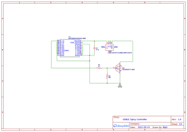

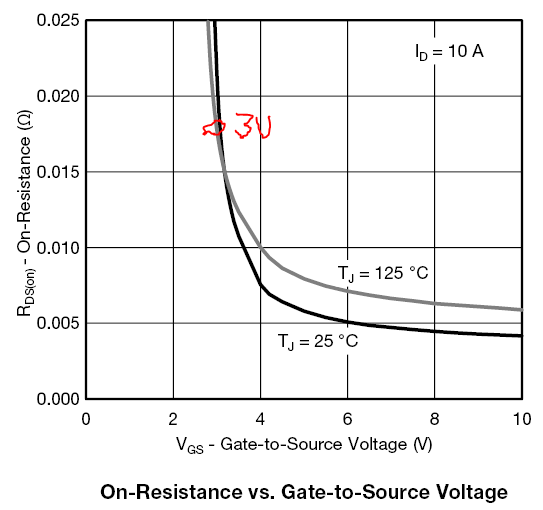

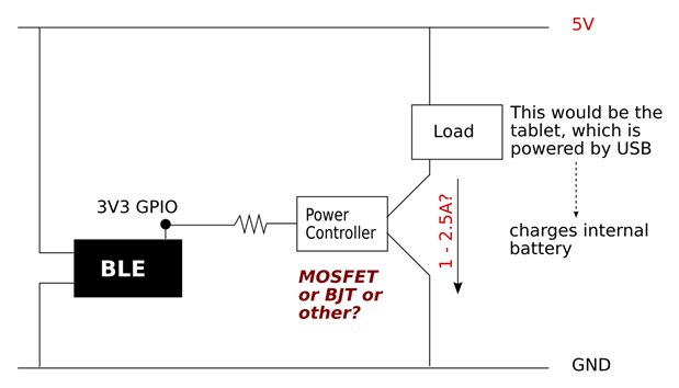

Anyway, this reminded me of a little project I had in mind (as shown in schema below).
As a electronics novice, this appears to be a borderline case as I know that transistors tend to work well for mA switches while MOSFETs tend to be targeted at higher voltages (and say +3A current).
So now struggling to choose a suitable component - I'm particularly interested at the 1.5A option as that tends to be the limit for many usb charger adapters:
Having done some prelim research it looks like FET's are the way to go but when working through my design criteria I'm quickly getting bogged down in the detail... In this case I'm not coming up with options as I can see that I need to minimise my resistance losses to reduce voltage drop etc... I'm also looking for a low cost <1$ SMD option.
Hence I thought to open this little design challenge to the members as I had to chuckle at aGough Lui status update I found when doing my e14 search...
Often we're lazy, choosing to use the same parts over and over. I'm guilty of this when it comes to...
So, any old favourite FETs you have which could well work here?
  • michaelkellett
    michaelkellett over 5 years ago +7 suggested
    Don't have favourites. Always use a part for a reason (usually many reasons). Having a reel of 999 of a part is a good reason if it will work OK ! In your case with 3.3V drive, 5V power supply, a load…

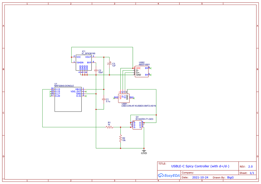

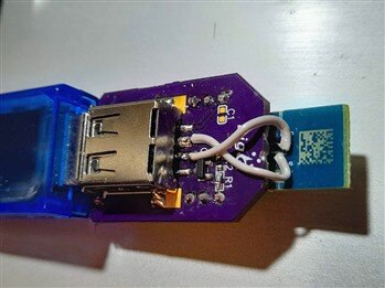

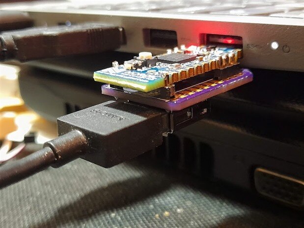

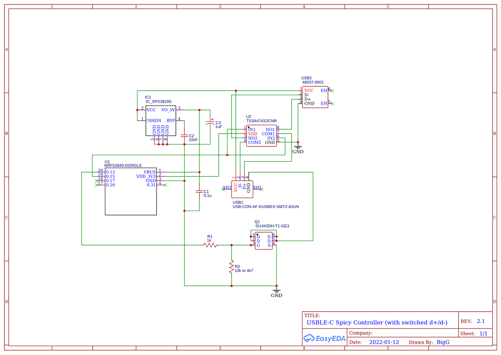

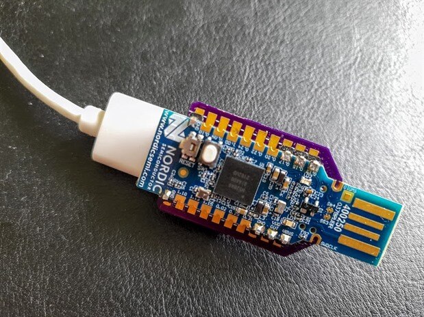

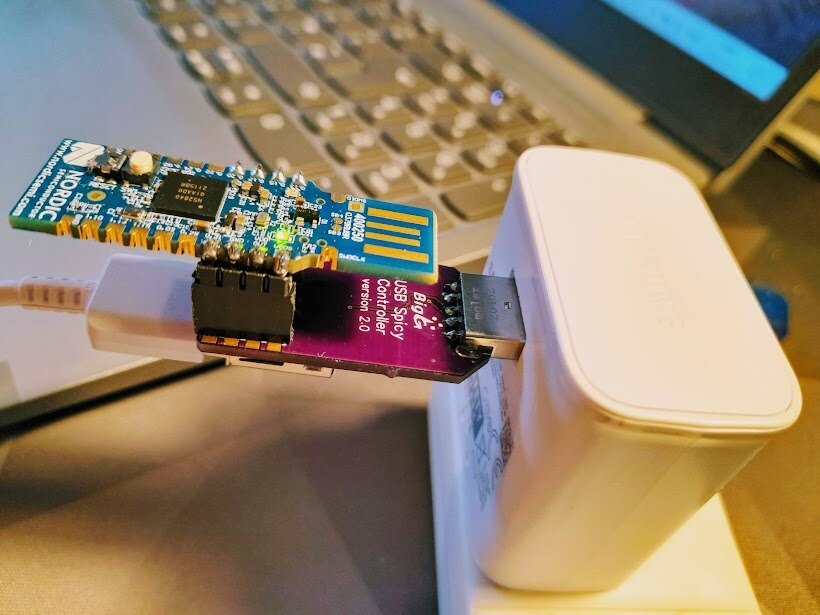

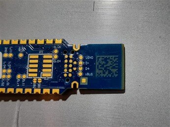

    As you know, from this forum post I started developing a USB BLE power or "spicy" controller a couple of months ago and thanks to your help I got a prototype (version 1) working.
    I've now been working on a version 2.
    The purpose behind this version is to get a controller to interface both with these new USB smart fast chargers, which work at higher voltage and a higher charging current, as well as a standard 5V USB charger -  my fast USB charger for my Samsung Galaxy A12 charges at approx. 9V and +1.5A.
    My design for this new version is as follows:

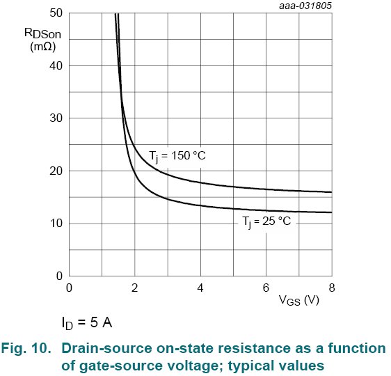

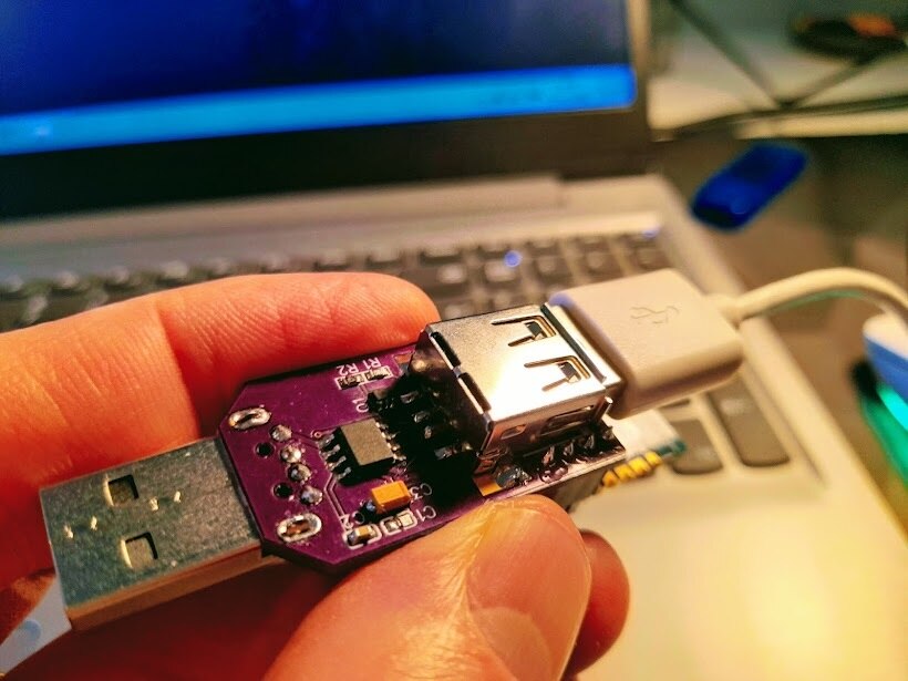

    It now includes a 500mA LDO (SPX3819 from MaxLinear) to drop the voltage to 5V for the BLE dongle and also uses a different N-Channel MOSFET (I'm using Si1442DH from Vishay which provides Vds @ 12V, Vgs @ 8V, Id @ 4A).
    {gallery}Spicy Controller V2

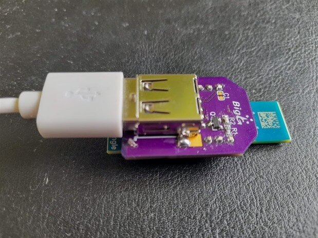

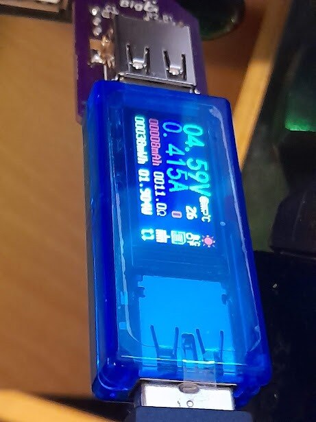

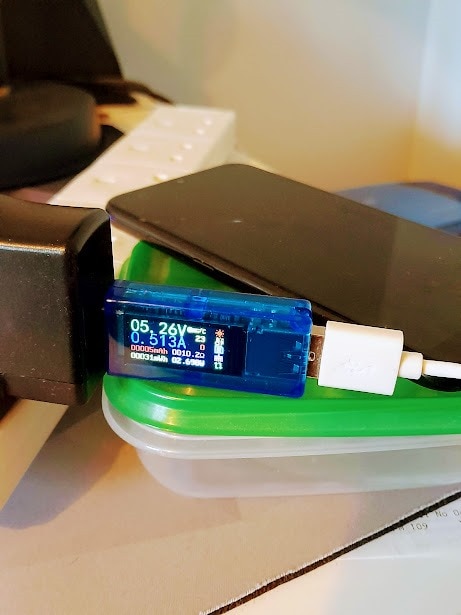

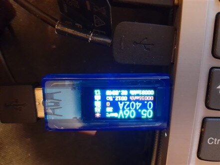

    I'm pleased to say that it works very well with the standard USB 5V charger...and here is the moment of truth video (my very first test using the new version)
    So there was some power loss (image below show power result without using the controller device). Nevertheless, I'm pretty pleased considering that this is pre design optimization.
    But it is not working properly with the smart fast charger.
    Yep, I discovered another problem for which I need further advice on.
    Hopefully the video made sense.
    So, when the USB voltage line for the phone is disabled via the MOSFET switch the USB smart charger switches off power when I plug the phone in but it works fine when throughput voltage enabled.
    So I'm assuming that the issue lies with the data lines and thus I thinking I need some way to disable these when power is off and enable when power is on.
    I'm thinking that an NC or NO 1 or 2 channel analog switch IC would work here. If so is it necessary to switch both data lines (hence using a 2 channel switch) or could I get away with controlling just one of the data lines, like D+ for example, with a 1 channel switch.
    If this is not the right component to use what else might work here.
    As always, I look forward to getting your comments.
    Thanks
    Colin
    0 shabaz over 4 years ago in reply to BigG
    Hi Colin,
    Great project! It may be worth getting a USB plug and socket separately and wire them up 1:1 (or buy a USB extension cable and split it to access the wires) and see what happens if one or both data lines are cut. Also, it may be worth considering cutting the +5V rather than the 0V connection, to see if that makes a difference. There may be a risk of powering up circuitry if the 5V is not cut, because the end device (phone or whatever) could be powering things at low current, through 5V and one of the data lines, since it's an unknown (to me anyway) how the smart charger negotiates the higher voltage. Also for this project, maybe the smart charger is not needed, since if the aim is to run a device for extended periods then you'd only want to charge to say 50% anyway, and keep it there, which is feasible with 500mA.
  • BigG
    0 BigG over 4 years ago in reply to shabaz

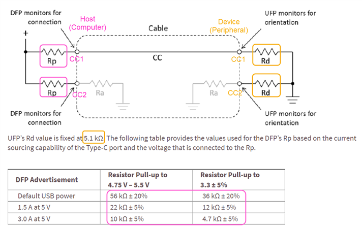

    Thanks Shabaz. It's getting there. More often than not you learn more through failures. As such your earlier replies about the D+ D- termination resistors and Battery Charging Negotiation Capability are finally beginning to make better sense. And hence sticking with this approach until I've run out of ideas.
    Your comments in your Silicon Labs roadtest review are proving very insightful. For example:
    "The USB power delivery is often negotiated, because it cannot be assumed that the power source has sufficient capability to power the load. "
    Standard Downstream Port – "If the USB device goes into USB Suspend then technically only 2.5mA is available."
    Apple and Samsung (and other vendor) proprietary schemes – "Depending on the DC voltage on the two pins, the remote device knows how much current it can draw."
    Dedicated Charging Port –"There is a fixed resistance between the two data pins. If the remote device detects this, then it will draw up to 1.5A."
    Charging Downstream Port – "By examining the voltage levels it will determine if the far end is operating in this CDP mode and the device will know it can draw up to 1.5A."
    What is still unknown is the applied tolerance to these various charging rules. The Cypress diagram explaining Rp, Rd, and Ra termination resistors has 5% and 20% tolerances for kOhm resistors. So that gives wriggle room.

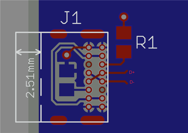

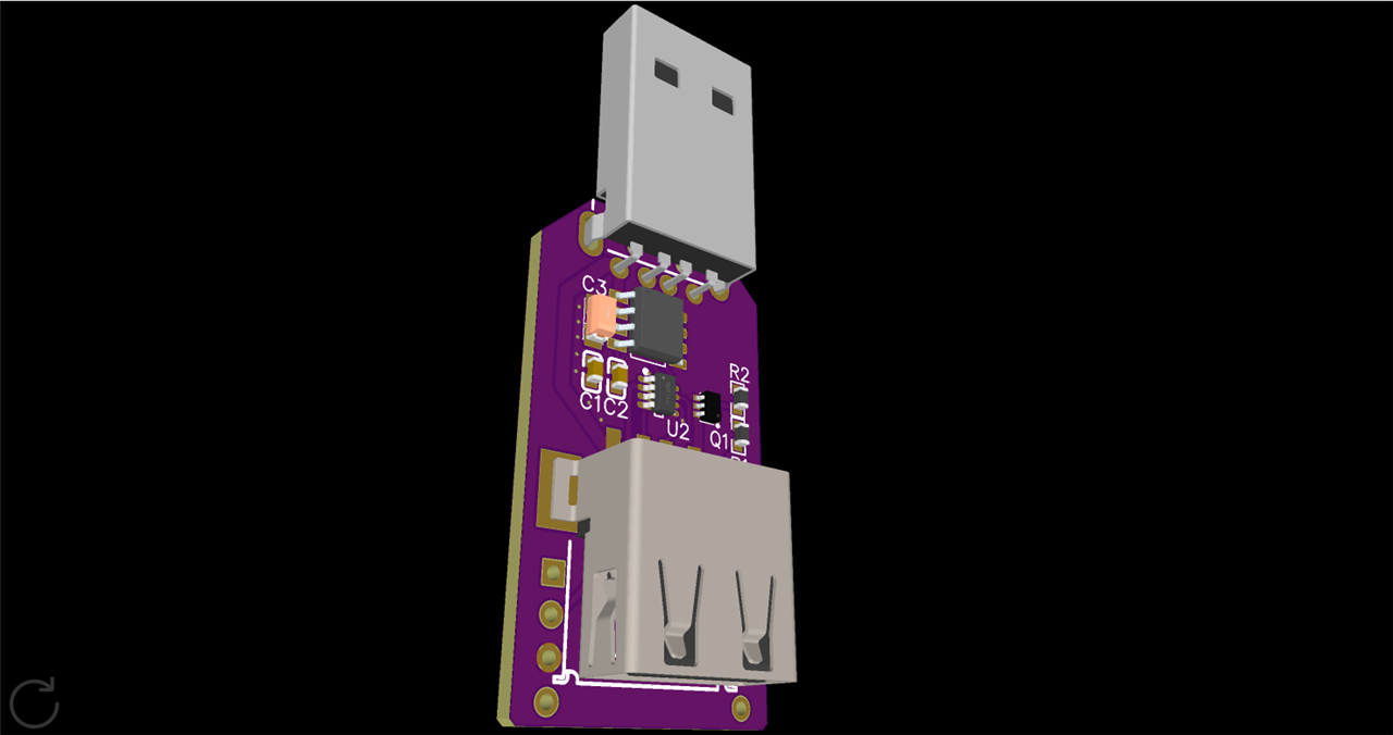

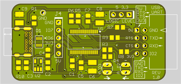

    As such I'm thinking that I can use an Analog Switch IC to disable the Data Lines altogether, which will then tell the smart charger that the phone has been removed (this is what I want) and then when I set the switch to Normally Closed it will introduce less than 10ohms of added resistance, which is hopefully well within the tolerances and thus won't change the charging algorithms.
    I've already gone and modified my schematic and pcb design. This uses a TS3A4741DCNR dual channel SPST analog switch from Texas Instruments. Hopefully this is a good choice. At least it will be easier to solder than that Si1442DH FET I'm using. That was the smallest component I've hand soldered to date.
    The 3d render looks pretty cool too.

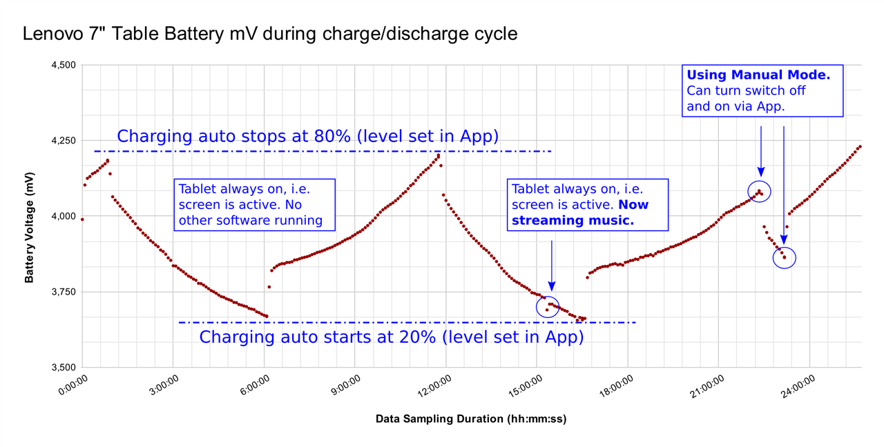

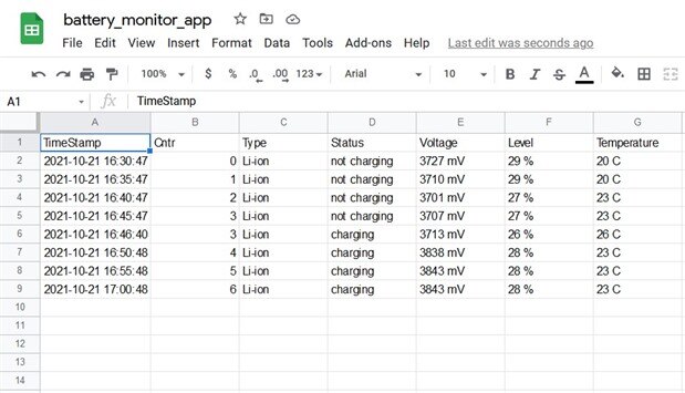

    I've been doing some tests.

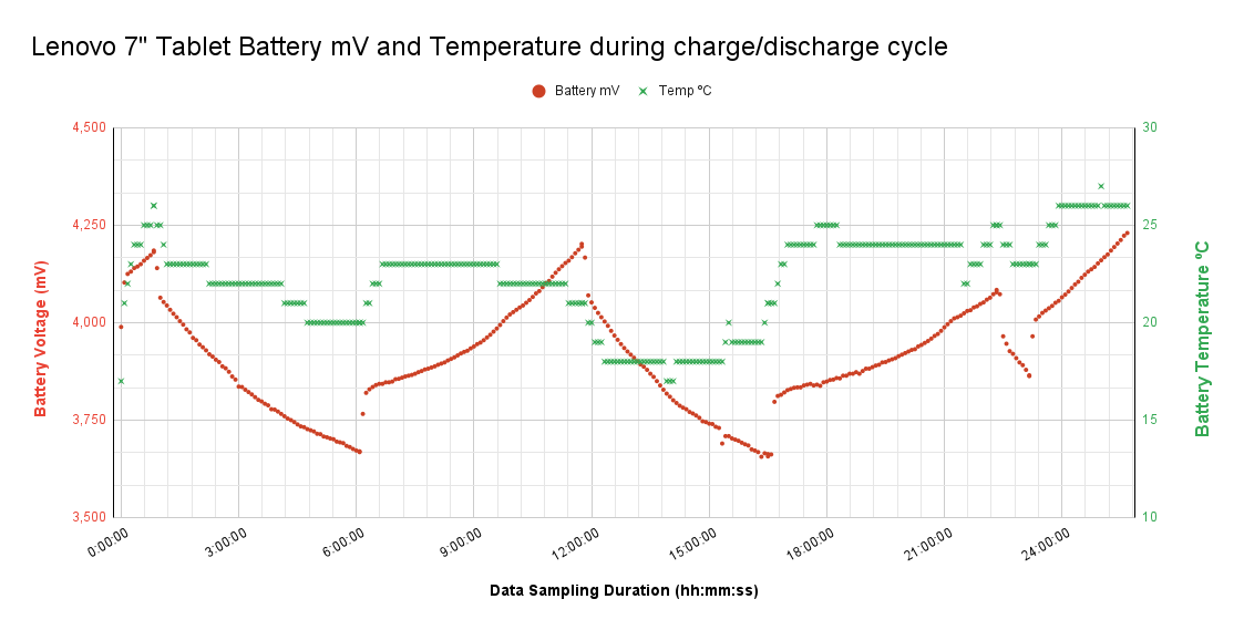

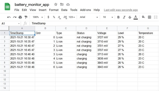

    I've updated my basic BLE switching firmware and have developed a battery monitoring test app for my Android tablet, which has provided some nice data so far. The test app pushes data straight to Google Sheets, which is extra handy. It's doing what I intended, so quite pleased.
    Here's the battery voltage results so far (the battery voltage come via Android OS):
    I can now play around within the app and create my own charging discharging logic. I am now wondering how long I should keep the charger active for, when fully charged or is this the way to do it, as in, hit your max limit then switch off charging until nearly discharged then kick in again.
    That's really great! Awesome seeing it work like that on the chart. I'm tempted to make this one day : ) I think it could make our mobile phones last longer. Bit ridiculous that I'm at home mostly and yet charging my phone to 100% every night, and within a year the battery life has noticeably dropped.
    Regarding algorithm, I don't know whats best, but my laptop has a 50% mode, which I've set it to, and it permanently maintains that, I.e. it doesn't drop below about 48% ever I guess.. So I'm presuming that is supposed to keep the life extended, while at the same time providing a reasonable level in case I did need to disconnect from the supply for a few hours. I use that 50% mode (there is no other option other than normal 100% charge) since the laptop is connected to the power brick 99% of the time, since it gets used more like a desktop.
  • BigG
    Thanks for the feedback. That's a very interesting option. I have no idea if my laptop offers such an option. I'll have to check this out.
    Searching online, I see there's a few blogs about lithium-ion charging cycles. Some mention temperature as being one of the contributing factors.
    As the battery widget within the app code captured temperature, I thought to log that data too. Here's the results. I noticed that the minimum temperatures were overnight when the tablet was discharging and there was no central heating on.
    I'm thinking that I could readily include temperature as one of the parameters too, to determine when to stop or pause charging the battery... it seems like 24 degrees is the plateau and then it peaks above 25 degrees on occasion, although not sure why based on this data as not always consistent (temp data between 10h and 12h seems off - maybe it was because the tablet was idle).
