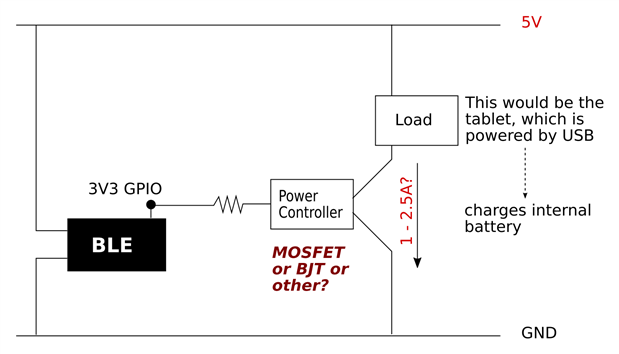

Anyway, this reminded me of a little project I had in mind (as shown in schema below).
As a electronics novice, this appears to be a borderline case as I know that transistors tend to work well for mA switches while MOSFETs tend to be targeted at higher voltages (and say +3A current).
So now struggling to choose a suitable component - I'm particularly interested at the 1.5A option as that tends to be the limit for many usb charger adapters:
Having done some prelim research it looks like FET's are the way to go but when working through my design criteria I'm quickly getting bogged down in the detail... In this case I'm not coming up with options as I can see that I need to minimise my resistance losses to reduce voltage drop etc... I'm also looking for a low cost <1$ SMD option.

    Don't have favourites. Always use a part for a reason (usually many reasons). Having a reel of 999 of a part is a good reason if it will work OK ! In your case with 3.3V drive, 5V power supply, a load…

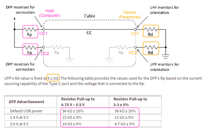

    Nice project! One thing you might (or might not) need (can be easily hacked in place hopefully, perhaps with surface mount resistors, is a resistance between the data pins, because the tablet/end device might not draw too much current without it - It's called Dedicated Charging Port (or other options are possible), I don't know the precise details but they should be published, there's some brief information here: SILICON LABS USB-TO-UART Bridge Controller EVM - Review
    (in the 'Battery Charging Negotiation' section)

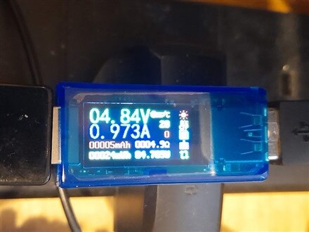

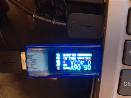

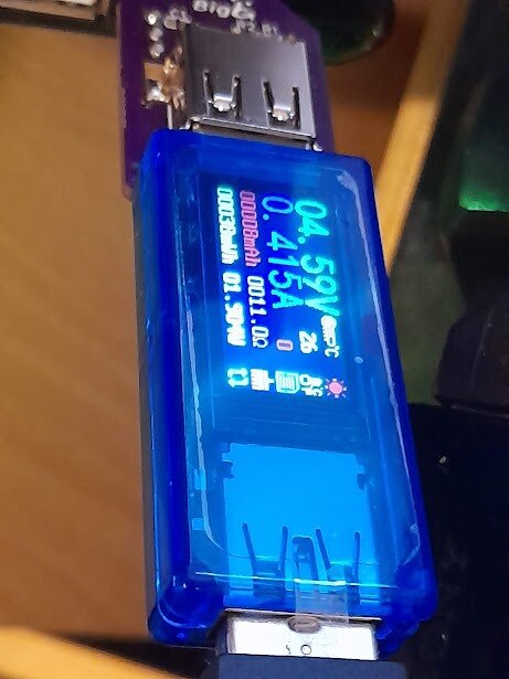

    I've just done some further testing and whilst it (sort of) works I can see that the current draw does differ depending on device and whether it is charged by laptop or otherwise.
    TEST 1: Charging tablet (Amazon FIRE 7) directly from laptop. Here the current draw is less than shown in the video demo.
    TEST 2: Charging tablet directly from a USB charger. Here the current draw is higher.
    TEST 3: Attaching the USBLE Spicy Controller to USB charger. Here the current draw is less and is similar to the current draw when charging directly from a laptop.

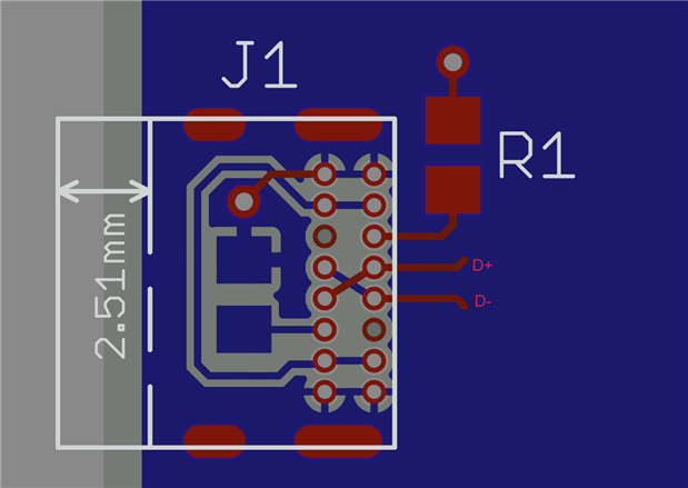

    I'm in the same situation, many devices with USB-C, so I ordered some connectors - they arrived today - so that I can in future lay out boards with that rather than (in my case for USB peripheral) Micro-USB. From what I read, since the connector works in both orientations, the data pins are replicated so they need to be connected together, and then there is a pin called CC, again replicated, and each of those separately needs to be connected via a resistor, to 0V or to the supply. The computer end (host) connects it high, and the peripheral end (device) connects it low. The diagram below was from a Cypress document but I found it hard to follow so I put some colour-coded annotations on it below.
    Personally I went with this USB-C connectorthis USB-C connector which is through-hole (I preferred SMD but I didn't see one that looked easy to solder). The through-hole won't be particularly easy to solder either, since the pins are extremely close, but that's life - I've bought enough to last me a while! so I have to go with what I have.

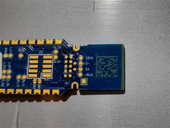

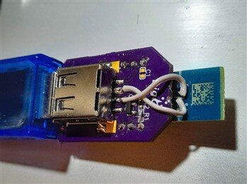

    The nRF52840 dongle has test points for the USB data pins, so I decided to use those to allow for pass through by hooking those up to the data pins of the USB-A receptacle connector.
    Whilst it does not give identical results in terms of current draw (with USBLE spicy controller vs without), the hack does appear to work.

    Indeed, it should work just fine with USB-C at least in its USB-A compatible modes by using a regular A-to-C lead.
    The resistance values on the CC lines using a USB-A to USB-C cable are usually configured to tell the end device to "fall-back" to other methods of detecting available charge current. Regardless, the connectors themselves shouldn't be used above 3A anyway, most USB-A devices never exceed 2.4A in the best ideal situations. However, in most cases, because of the USB-BCS rules, devices will fold-back their current if they detect the charger is being overloaded - this is done by watching the voltage. This is mainly so that if someone plugs a new phone into an old USB 0.5A charger for example, it doesn't trip the OCP. This fold-back usually works very well, resulting in slower-than-normal charging on long leads, thin leads and/or worn connectors.
    I'd probably be more concerned that the Nordic board doesn't have a "proper" USB connector, as the PCB-pad connections do not have the raised ridged profile of proper USB pins and the contact pressure may not be optimal. Drawing so much current this way could lead to "intermittent" resistance changes which may mean downstream devices fold-back and charge a bit slower. Of note is that USB meters also will add additional resistance due to the connectors and sensing shunts - sometimes a small wiggle of the connection and you can see the fold-back in action.

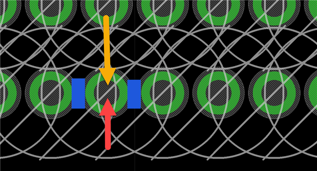

    0 shabaz over 5 years ago in reply to fmilburn
    Hi Frank,
    You're right, it's very likely solder mask will break in the blue regions here. The spacing between the rows is a bit more, so hopefully if the iron and solder are applied as shown with the red and orange arrows, then hopefully it's doable.. it's really tight though, the pitch is 0.85mm between pins within the same row.
    I gave the layout a shot, that is more complicated than Micro-USB since the two resistors are needed, but it is not too bad provided at least one resistor is on the underside of the board, otherwise it's a lot more awkward. These resistors are 0805 sized in the screenshot below. I might tweak this a bit more, but I think broadly I'm going with this sort of layout.

    If it were me I'd be quite happy with surface mount.
    Farnell have 3019726 which is Hirose CX90-M, it has the connector pins on a 0.5mm pitch, same as a typical surface mount uP.
    No problem at all to hand solder if you use flux and a sensible iron.
    And a piece of cake if you silk screen and reflow.
    The SM connectors cost more image
