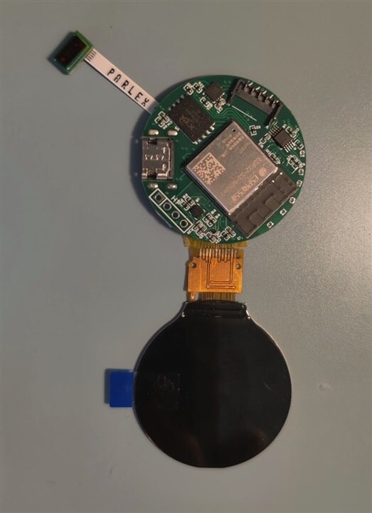

Hi 14-ers, this is my first post to the forums. I hope it's not too strange of a question. I am excited to be working on a new open-source platform (hardware and software) for making mobile storytelling experiences. (https://github.com/frankcohen/ReflectionsOS). I hired a freelance PCB designer to take my breadboard and create the schematic and layout. I will be taking the design to a board assembly company to build prototypes - along the path to manufacturing. I am new to the PCB designer community. Is it acceptable practice to ask other PCB designers here to review the schematic and layout? Is Element14 forums the right place? Should I hire someone to be a reviewer? I'm thinking the more eyes on it the better it will be. -Frank

    The board layout, front and back: I will be publishing the EasyEDA project and Gerber files this week. -Frank

    The antenna for U1, should have no components or copper or ground plane flanking it. You've got traces and components on both sides of the board, where there should be clearance for the antenna. With the current layout, the WiFi is sub-optimal. Didn't any of the 4 PCB designers pick up on this? I'm not a PCB designer..
    shabaz over 4 years ago in reply to shabaz
    It's worse.. just took a look at the Gerber files in the repo. There are three layers in the 6-layer! board, which have power planes on them - all across the antenna area.

    Yep, the board above is the Revision 1 (code named Sox), the Revision 2 is code named Hoober. We went to 4 layers. We moved the Wifi antenna to have fewer traces underneath. I'm not expecting to use Wifi much because of the huge power consumption. Hoober Gerbers are at https://github.com/frankcohen/ReflectionsOS/tree/main/Devices/Hoober. I would love you to dig and criticize, that will make it better. -Frank

    I used PCBway to make the Hoober (rev 2) boards and Surface Mount Solutions in Santa Clara, California, for assembly. Both are great companies. I downloaded the Gerbers again from PCBway to make sure. Please check the repository again today., I did an update.  Hoober is 45.88x73.77mm, 4 Layers,Thickness:1.6 mm, Finished Copper:1,Surface Finish:HASL with lead. Let me know if this still isn't complete. Thanks! -Frank

    It's hard to examine the files without a zip file of Gerbers, otherwise people have to download 600Mbytes of the github repo just to examine a few kbytes of Gerbers. If it were a single file in the repo, it could be downloaded easily.
    Anyway, everything above the blue line should be absent. The PCB designer doesn't understand that you can't have ground/power planes flanking the antenna. Even if WiFi isn't used much, it's not a frequency of use or data volume issue; the times you want to use it, the radiation pattern is affected because of the planes and components.

    Good points. I added a Zip of the Gerbers at https://github.com/frankcohen/ReflectionsOS/blob/main/Devices/Hoober/Hoober%20Board%20Gerbers%20Avinadad.zip.
    We're working on Rev 3 of the board (codenamed ThingTwo) and will incorporate your change for the radiation patterns. In the past we had the board physically cut out below the ESP32-Mini antenna array, we will do that again.
    I'm concerned about the GPS for the same reason. There's not much information about the AT6558 internal frequencies. And I am considering using a tiny SMT antenna, though I am expecting a lot of problems getting accurate position and time readings. What do you recommend?

    Here are photos of the Hoober board - front and back - without components. image

    Wouldn't doing it without the cutout be better for mechanical strength - just leave it without any copper traces or planes? The antenna is one of the heavier components and this design seems to higher the chances on physical vibration?

    It's 34 mm round and fits into a wrist watch case. The case provides the strength. Still you make a good point, we will make sure the traces and planes are not underneath the antenna.

    What I mean is as Jan say, I.e. you can leave the FR4 there if you like (I assumed you would for mechanical reasons), it's the copper and components that are not required.
    It's not just about underneath the antenna. It's about everything northbound of the blue line, i.e. to the sides of it too.
