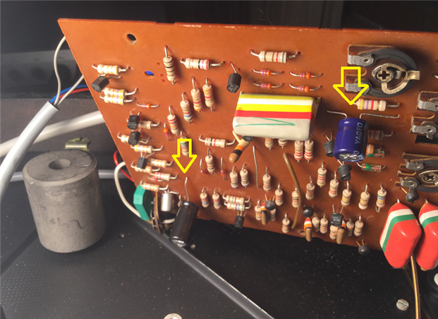

    0 Jan Cumps over 4 years ago in reply to Graeme
    Graeme said:
    Re the motor. Mine also starts up quickly but occasionally the pitch varies (wow) for a few seconds
    Most likely not a motor issue. There are a few players that can influence it:
    • stability of the power supply.
    If not done yet, replace the capacitors on the locations I've flagged with the yellow arrows.
    The photo shows the after state. The original ones are blue Philips electrolytes.
    If they are still there, replace. If you have an LCR meter, you can see for yourself that they are out of spec. If not, just assume they are bad.
    Electrolytes have polarity. Replace with same value, (at least) same voltage and in the right direction.

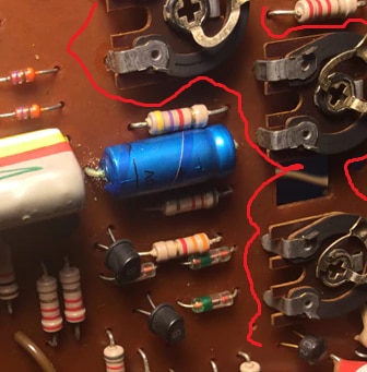

    • check the contacts of the potentiometers and trimmers that influence the speed, and the feedback circuit
      the two upper circles are the pots and trimmers. Maybe they need a contact clean. They are all sitting on the PCB and look like this
      (in this photo you can also see one of the old electrolytes that need to be replaced, in bright blue. It's C730 that has impact on speed stability)

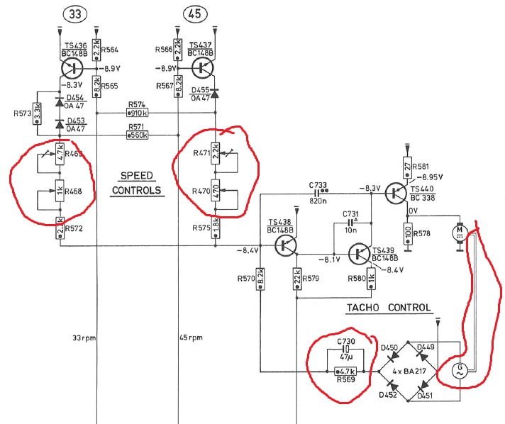

      Check the tacho cable from motor to PCB. Bad contacts?
      Check the value of C730, or better, replace it. It's one of the two electrolytes.
