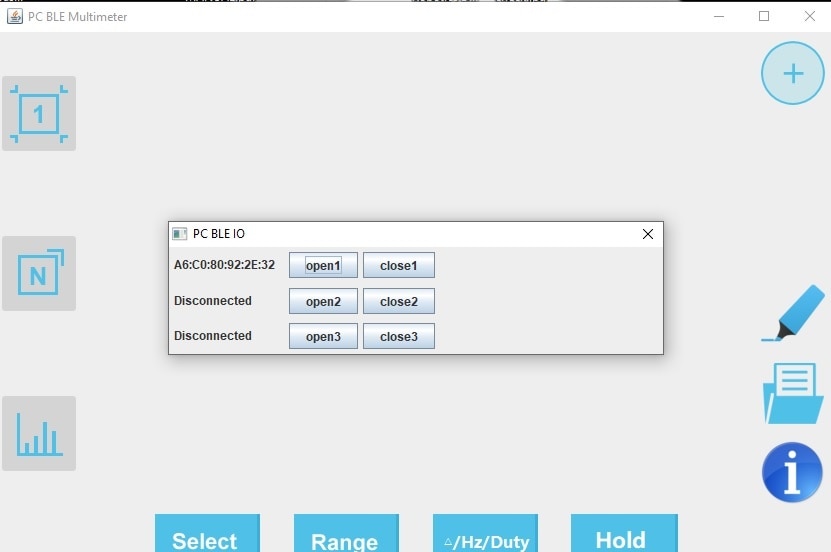

    My previous message I couldnt identify the DMM by BLE address,  after multiple tries of shutting the DMM off and ON, finally the address is identified. but still the DMM tool screen is empty, as if not properly connected. Please advise any suggestions.
    Thank you
  • robogary
    0 robogary over 4 years ago in reply to Prasanth Arockiaraj
    Hi  Prasanth Arockiaraj - Weird , my PC got a big Windows update today, and the OWON PC tool started working. Thank you for your help and listening
