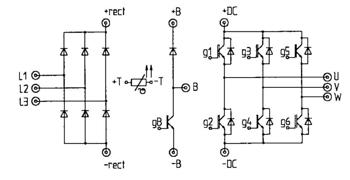

imageThe hot topic for those who owns DX200 welder and willing to participate in re-implementing of the original PowerModule on discrete elements.
This is continuation of the discussion and efforts already put into at other forum:  Miller Boost Circuit Board Assembly NO. 200841
This is a restoration project attempt of reproducing using discreet components an obsolete  power module  which SkiiP 33NEC125T2 no longer produced by SEMIKRON.
DISCLAIMER: This is a high voltage project DANGER. Anyone who joins this experimental project need to be aware of high voltage (up to 1000v) and high currents (up to 100A) which is a high risk and requires to be qualified to work with such circuits and can be done only at your own risk.

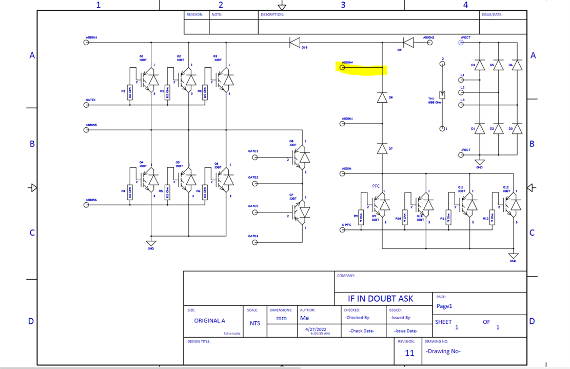

    I am no longer interested working on this project. Seems to me besides two people nobody else step forward. I have specially missed one pin on Schematic design, after I ask you to double check my work…

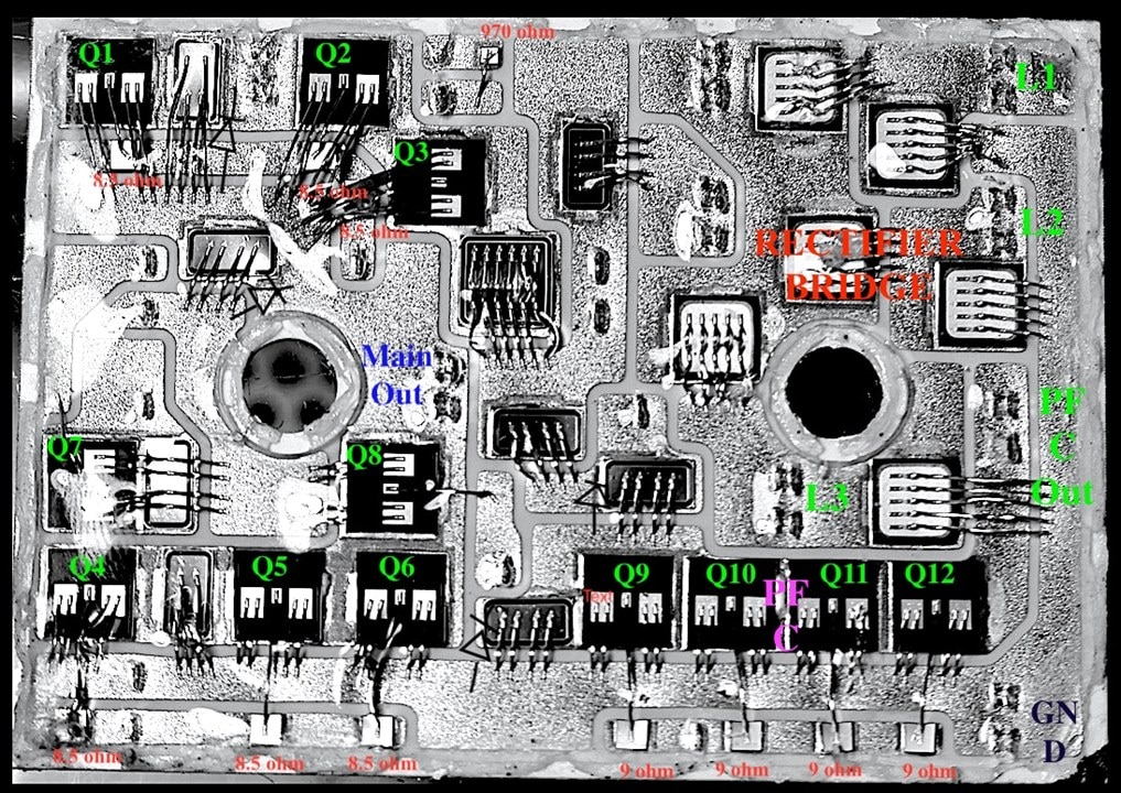

    Here is the assumed topology of the OEM diagram:
    I am doing in this order:

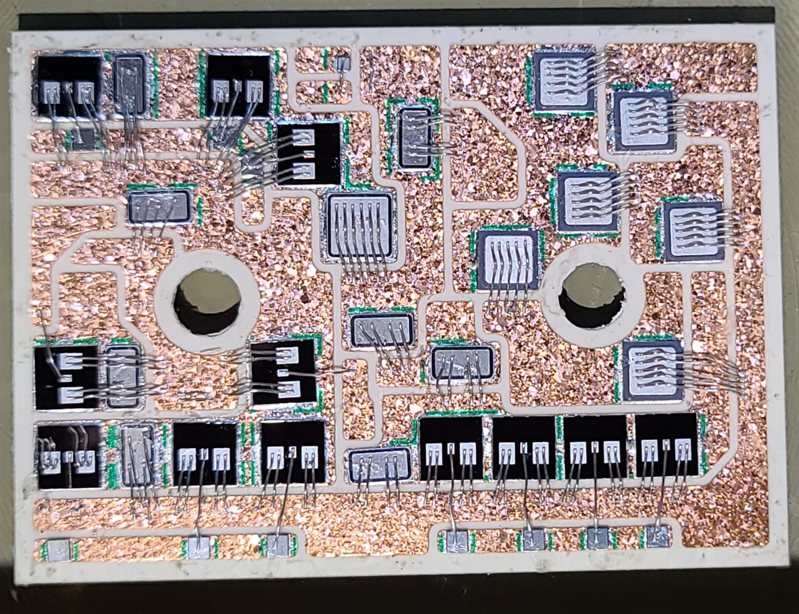

    Separate Diode Power Bridge Rectifiers from IGBT components to reduce a heat spread.

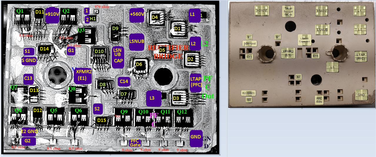

    OEM PART IMAGES:
    image image
    Now side by side:
    Here is someone else's work so I do NOT take credit for reverse engineering ( also this all just assumption based on this diagram )
    Based on the diagram on the image following components is no longer available for sale:
    Component released on : July 2007
    And last but not leased another member of this forum made a PCB preview ( PCB not complete and needs redesign )

    it seems the bottom right corner of the original has 4 IGBTs in parallel which are used for PFC, not really critical if higher amps IGBTs used.

    I haven't not complete entire reverse PM to RC pinouts. however, as of right now looks like PM controls by ASSY NO. 207822 and not by Boost Board assy No: 200841

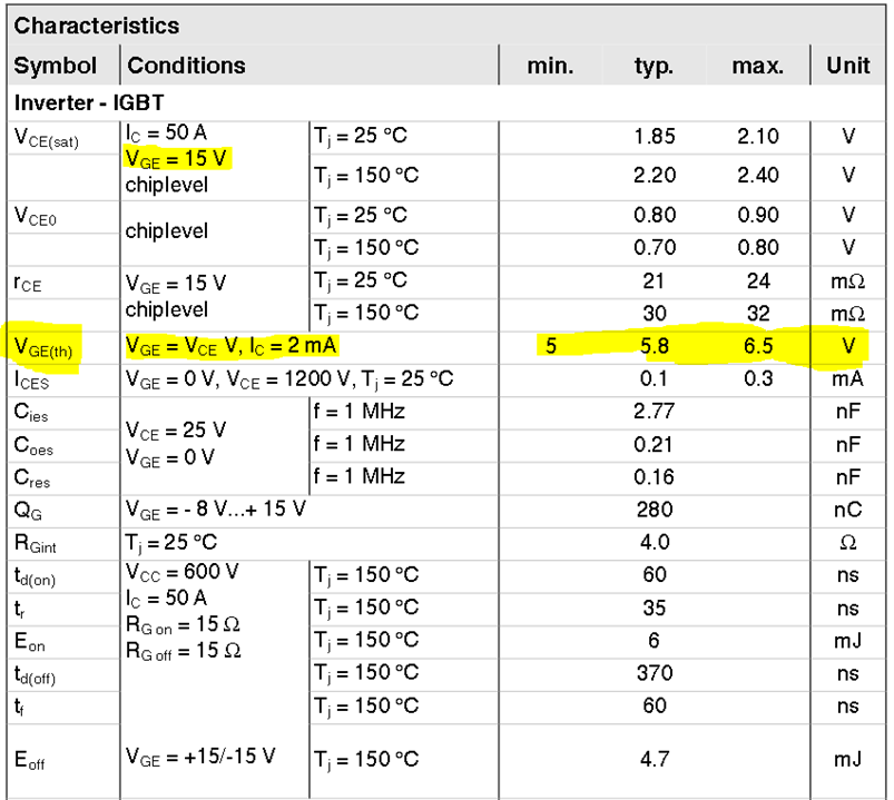

    F.Y.I. below is fragment of the "Vge threshold" that we're looking for from the datasheet you posted above:

  • mb443
    mb443 over 4 years ago in reply to lanuser
    The first datasheet shows Vge (th) threshold in the range of 5 to 6.5v w/ average 5.8v and that measurement is done at 6ma in load, typical value of Ic is 250uA, not sure why german company decided to go w/ 6mA, probably it is their standard, but it's Ok.
    As of second datasheet above does not publish Vge threshold at all, so, you can only guess.
    Also, there are 4 generations of those SkiiP Power Modules and all are different as designed at different time,
    So, guessing may get us in trouble. Another parameter is Vce sat - also important as size of the radiator directly depends on the value of voltage  drop on collector-emitter at max load let say 50A will get us to let say Vce sat = 3v will be needed to dissipate 150W where 3v drop is a real number from datasheet above, and that is way over for DX200 radiator. So, less value is a preference,
    As I've heard this 33NEC125T2 is heavily customized specifically for welders schematically w/ the best IGBTs used at that time, so I'd be careful, but sure you can experiment with what you have, you gotta start with something. Meantime, I'm thinking about the way to take measurement without destroying good power module which I can't afford, and we need to get a close match by most critical parameters and better match those IGBTs will help us to get a stable outcome.

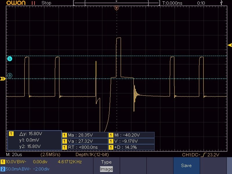

    i have Miller DX200 powermodule main points waveforms (oscillograms). Maybe it change Your mind to continue this project?
  • serg200010
    serg200010 over 4 years ago in reply to alvideo
    it will be Great! you you mind to share waveforms?  Thank you!

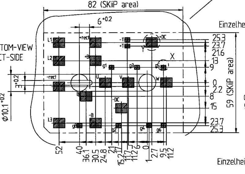

    If someone is interested I can repost Power Module images of reverse engineered info with "mb443" and i.

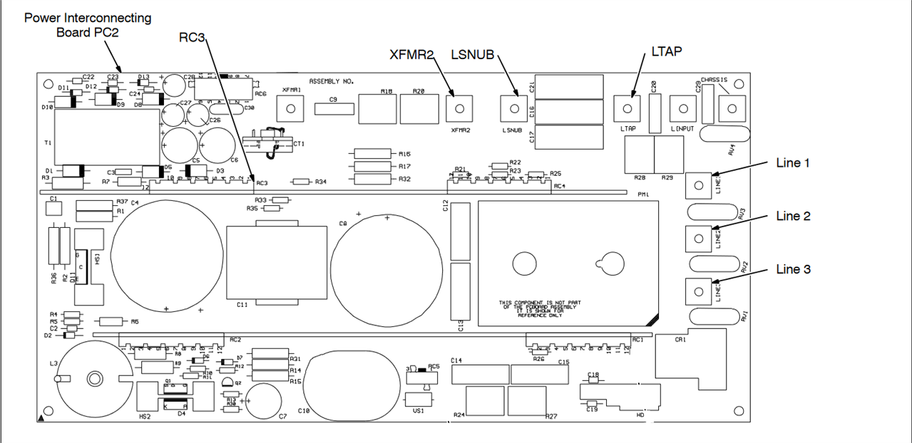

    All waveforms are taken in MMA mode, No LOAD (few years ago from working and tested Dynasty 200 welder).
    Waveforms test points named as in service manual documentation (Page 70-71)
    https://elektrotanya.com/miller_dynasty_200sd_dx_technical-manual.pdf/download.html
    01 RC4 1-2 Drive IGBT Gate 28 kHz
    02 Main TRANSFORMER XFMR1-XFMR2
    03 RC1 4-3 Boost control (PFC) IGBT Gate 20kHz
    04 PFC Choke LINPUT-LTAP
    05 RC4 5-6 Snubber IGBT Gate 28kHz
    06 LTAP-LSNUB
    07 RC2 4-6 BuckDrive
