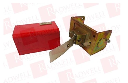

    Environmental monitoring was the norm in high-power equipment. I recall vane-switches, not much different than this beast as a  sensor in a complex system to keep 50KV transmitters cool.
    We spent a considerable bit of time doing fan motor and filter maintenance. Few new techs from school had ducting experience. Airflow was critical to keeping the equipment on the air. Banging tin was just part of the job.
