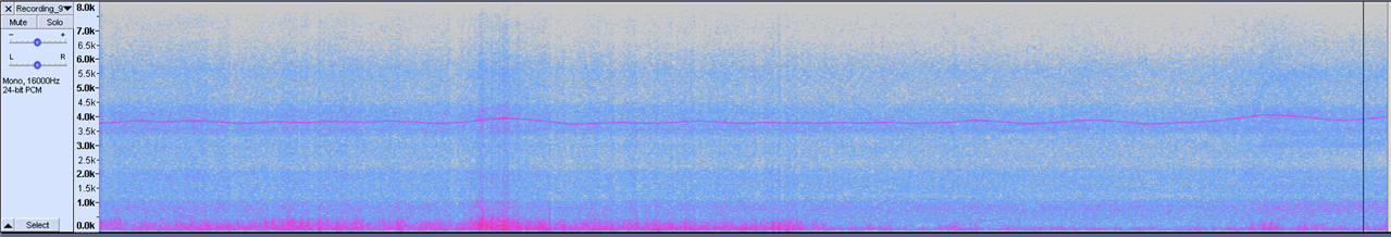

I've recently received a device and it has a fan built into it for cooling, but I've noticed a particular whine with it:
A very high volume 3.7khz pitch whine/noise from it.
What could cause such a noise? and more importantly, what should be the solution?

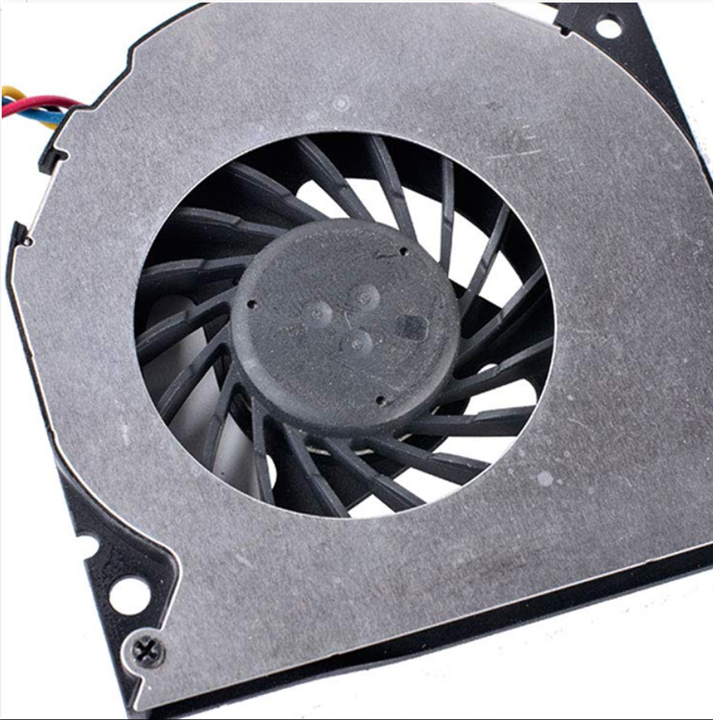

    Anyhow, I did a quick search online to see if I could find some pictures and I found some on Amazon - this is a screencapture.
    I'm guessing here, but maybe try and loosen that screw to see if it makes any difference as could be enclosure related (as @shabaz has noted).

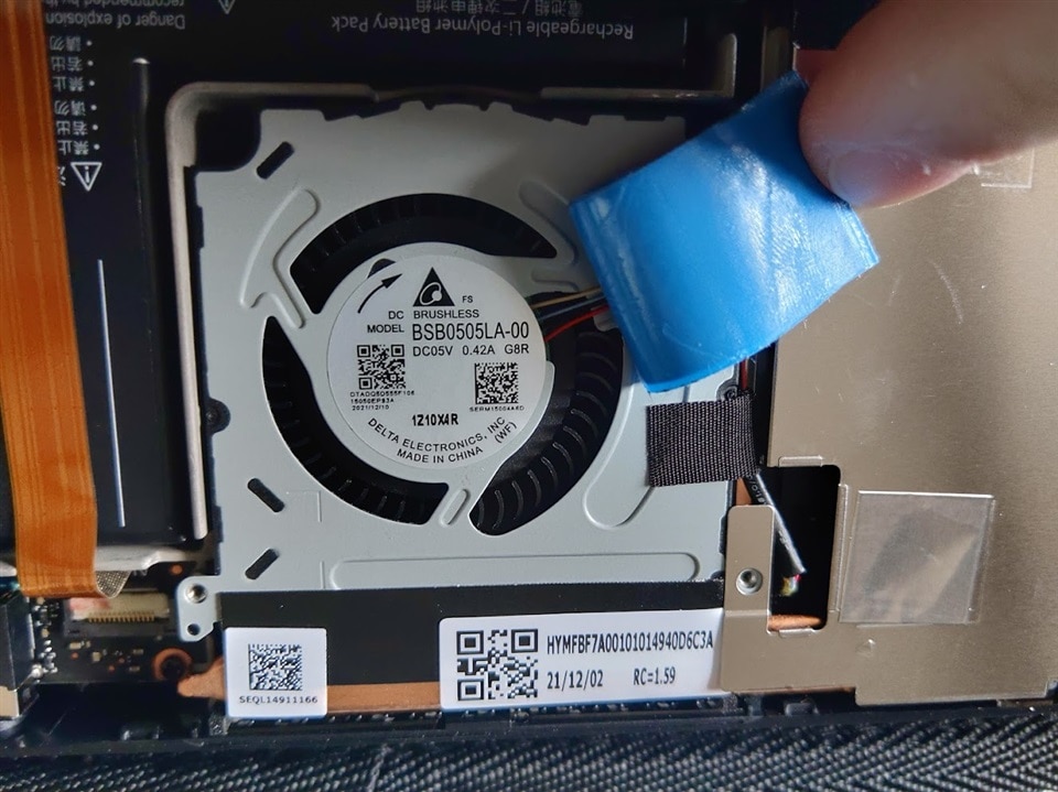

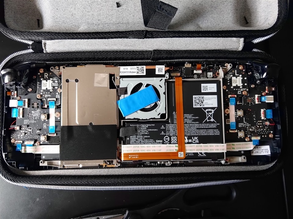

    Here's a reveal of where the fan is situated:
    It's inside of Valve's Steam Deck.
    you can disregard the blue tape, that was there to check the noise while I moved the fan, here's what it covers:
    The community behind the steam deck have discovered there's two brands of fan in the steam deck, this Delta, and one by Huaying, and the Huaying typically doesn't suffer from the high whine.

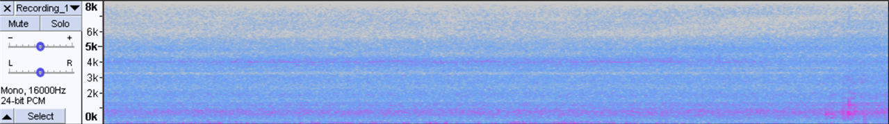

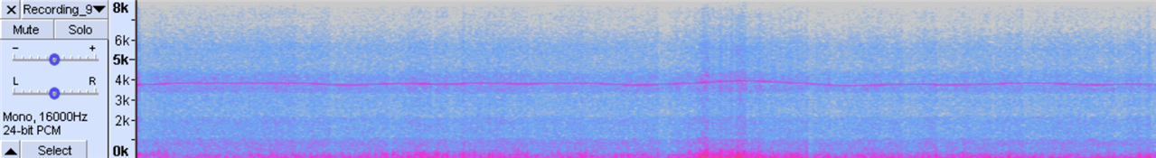

    Securing the enclosure, and the nearby aluminium shielding has reduced the noise somewhat, but it is still there.
    Before:
    After:
