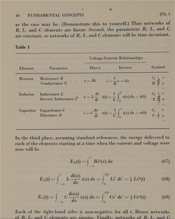

    On mobile so cannot write much but this also states it as you say (from the book Electrical Network Theory) on pages 39-40 here: https://archive.org/details/electricalnetwor0000bala/mode/1up?view=thea…

    0 shabaz over 4 years ago in reply to michaelkellett
    On mobile so cannot write much but this also states it as you say (from the book Electrical Network Theory) on pages 39-40 here: https://archive.org/details/electricalnetwor0000bala/mode/1up?view=theater

    0 TekMaker over 4 years ago in reply to shabaz
    Oh well, I am man enough to admit when I am wrong. I haven't done electronics professionally for over 20 years, but did it since leaving school
