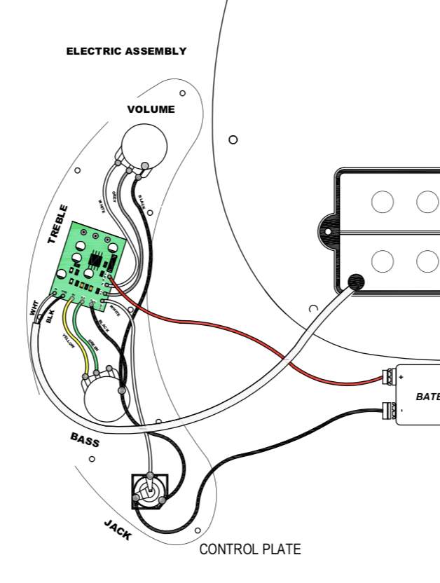

Bought an electric bass guitar from a pawn shop and bought a guitar amplifier from guitar center. Plugged it in tried tuning it installed new wires but doesn’t sound similar to the stingray bass guitars I’ve seen on YouTube videos. Did some research and had symptoms of wiring problems. opened it up to diagnose it, only to find a bad soldering job and what I think is an after market built in preamplifier. Desoldered and soldered all connections as it was but still didn’t solve the issues. Finally Decided to completely tear it down and found battery wires were connected wrong. Forgot to draw a wiring diagram and didn’t take picture for reference before dissecting it. Now I need help rewiring everything. I’m trying to find information on proper wiring diagrams but none include the preamp. It’s an electric bass guitar with a 5 way switch, 2 humbucker pickups and 1 volume and 2 tone control knobs. The preamplifier pcb has no part number to look up but is designed with a Texas Instruments ic chip TL071Cimage

    This wiring diagram looks like it could be what you are after: https://www.talkbass.com/attachments/a31c587f-decd-4f99-bcb2-973962bd744f-jpeg.3460200/ The wiring colours match Jan's images as well…

    A little bit of reference. At least some wires visible: wire broke off on sterling stingray 5 . It's the same PCB and https://imgur.com/gallery/ORFZysM

    Jan Cumps over 3 years ago in reply to beacon_dave
    great find!. One more image from that post:
    MTapia96 , this should put you on the right track.

  • MTapia96
    MTapia96 over 3 years ago in reply to Jan Cumps
    I don’t see a 5 way 4 pole switch and your bass got 1 or 2 humbucker coils, cuz mine has 2 humbucker coils with 5 wires for each humbucker

    MTapia96 over 3 years ago in reply to beacon_dave
    Almost the same but I got 2 humbucker coils with a 5 way switch but I might use this one and hook up the coils in parallel sequence not sure yet
    Jan Cumps over 3 years ago in reply to MTapia96
    The pickup switch will turn the 2 humbuckers into 2 wires. You'll have to find the wiring schematic for that part of the instrument.
  • MTapia96
    MTapia96 over 3 years ago in reply to MTapia96
    • I got wiring diagrams on how to wire the 5 way 4 pole switch with the pickup coils in parallel, a custom one with added switches for different features and in series the stock wiring. I got them off a site which shows how to connect two dual/double or split coil humbucker pickups I don’t know the correct terminology as I am a noob and beginner in electric guitars. Also when I removed battery holder there is another circuit board with just a diode. Don’t know if y’alls has one too but I think that’s were the problem was. As it was wired in a way that I thought was incorrect and sketchy, used my multimeter to check the correct voltage output pin all I got to do now it apply the switch wiring to the diagram @beacon_dave provided and I should be good. Once again much appreciated and y’all for the support wish me luck.
    That will be a diode to protect the circuit if the battery is placed wrong.
