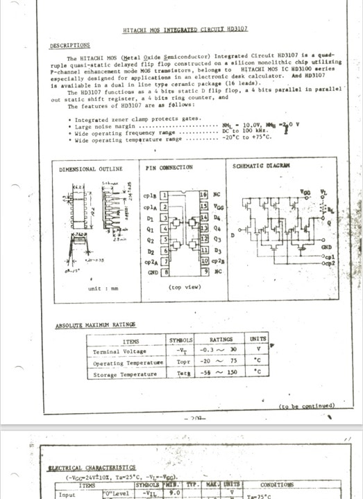

    In looking further in the limited set of Hitachi parts that found, the HD31xx parts are MOS devices, Here is a screen shot of a HD3107 from Hitachi: They are showing VGG values of 24V +/- 10% and VDD…
    They are showing VGG values of 24V +/- 10% and VDD values 14V +/- 10%, so these are in the ballpark of what you are seeing.

    There are some more data sheets from the HD3100 series here:
    https://www.oldcalculatormuseum.com/t-hitachihd31xxdata.html
    Also UTsource describes it as "HD3111 is a high-speed, low-power, high-performance CMOS logic device manufactured by Hitachi. It is a dual 4-input NAND gate."
    0 genebren over 1 year ago in reply to beacon_dave
    Yeah, that is the same source that I had found.
