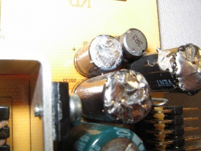

Why do some electronic devices that were working stop working if they remain unpowered for long periods? Is there an explanation for this and is it possible to avoid it?
  • colporteur
    colporteur over 1 year ago +3
    Components especially electrolytic capacitors dry out. It not from use but age. I have a set of hips that have the same problem:)

  • aswinvenu
    aswinvenu over 1 year ago
    Like colporteur has pointed out, This could be due to dried out electrolytic capacitors.
    Or it can be due to corrosion or some deposits on the PCB. You could do a visual inspection and make sure it's not the case.
    A good quality semiconductor part wont go bad if you haven't used it in a while.

  • robogary
    robogary over 1 year ago
    Don't forget batteries die and corrode connectors. Power down conditions can't drive off moisture that can cause issues on poor solder joints and pads, and some components will absorb moisture to cause internal degradation.
