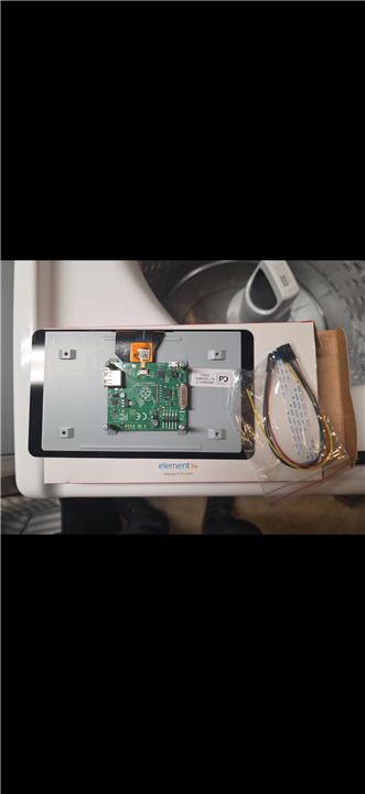

A family friend gave this display to me. I’m working on a project to put a screen in my car and route it through the factory harness and aftermarket system I have. All I am wondering is if this 7” touchscreen is bright enough to be seen during the day? Specific specs would help most!

    It’s for a 2001 Lexus Ls430. I’m using a grom system that allows me to use the factory OS and android OS. I can switch between either and it still looks factory. The grom system will only allow me to add a secondary display at a resolution of the original display as it’s mirroring the factory one (480p) but this display is from 2001 and it’s a very dark lcd (200nits) so this raspberry would be a nice little project if it’s bright enough to be worth my time. I’ll add some pics below to help.

    0 shabaz over 1 year ago in reply to Cpk
    Hi,
    This won't work. What interface does your Grom system use for the secondary display?
    The Pi display has no standard external video interface to external devices like your Grom system, instead the Pi display uses a special intra-system interface over a ribbon cable, designed to attach to the Pi and nothing else (at a high level approximation).
    Furthermore, the Pi has no video input interface either.
    Maybe the Grom system supports something thst may make it work, but I'm unfamiliar with it, and I think it's a safe bet to assume the Pi display will not be compatible in any direct way.

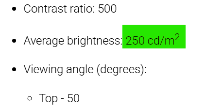

    0 beacon_dave over 1 year ago in reply to Cpk
    The R-Pi 7" touch display is only 250nits
    https://www.raspberrypi.com/documentation/accessories/display.html#raspberry-pi-touch-display
