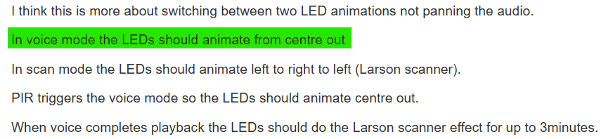

    Hi Shabaz,
    I think you have misinterpreted the post here.
    I think this is more about switching between two LED animations not panning the audio.
    In voice mode the LEDs should animate from centre out
    In scan mode the LEDs should animate left to right to left (Larson scanner).
    PIR triggers the voice mode so the LEDs should animate centre out.
    When voice completes playback the LEDs should do the Larson scanner effect for up to 3minutes.
    If PIR is triggered during the 3minute Larson scanner timeout, then the timeout should cancel and reset and the LEDs should animate centre out.

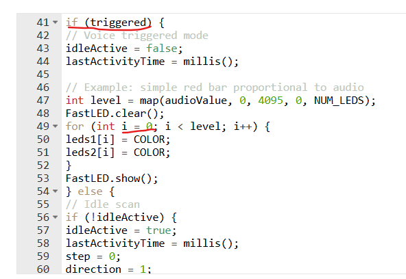

    0 beacon_dave 8 months ago
    Unknown said:
    I have a version that works, the voice triggers but it comes out from the left and not centre out.
    Probably because when the trigger condition occurs, you are starting to fill the array from index 0 which will be the leftmost LED and not the centre LED.
    If you turn on code formatting, it will make your code easier for others to read.
    Also if you add some comments indicating what each section relates to.
