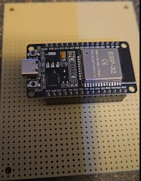

In this project, Mark builds a Larson scanner—an animated LED effect made famous by Knight Rider and Battlestar Galactica. Unlike many similar builds, this version includes synchronised sound effects, bringing an extra layer of authenticity to the visual sweep of the red “eye.” The project is customizable, allowing users to modify the number of LEDs used, brightness, animation speed, and tail length, making it suitable for a wide range of applications from cosplay to home decor.
ESP32 and Audio Integration

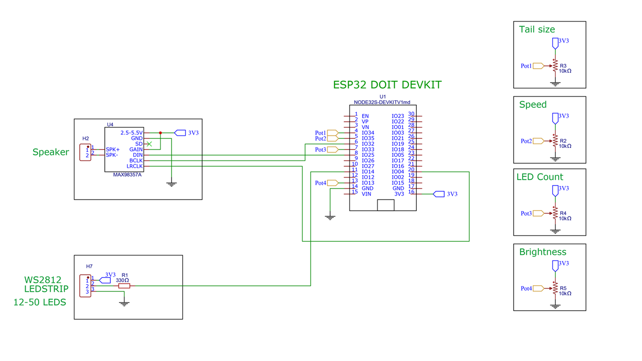

At the core of the build is an ESP32 development board—specifically one that supports dual-core processing. One core handles the LED animation, while the other plays the Cylon sound effect. The sound is generated through an I2S audio board connected to a speaker or speaker exciter, which vibrates a surface to act as a large resonating speaker. This unique approach allows for louder, more immersive sound without requiring a high-power amplifier.
LED Control and Hardware Configuration

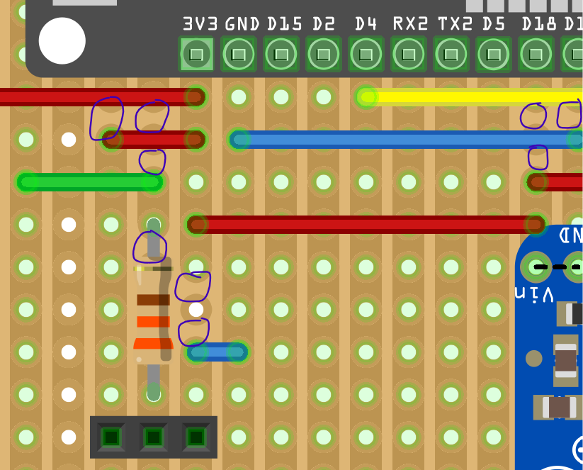

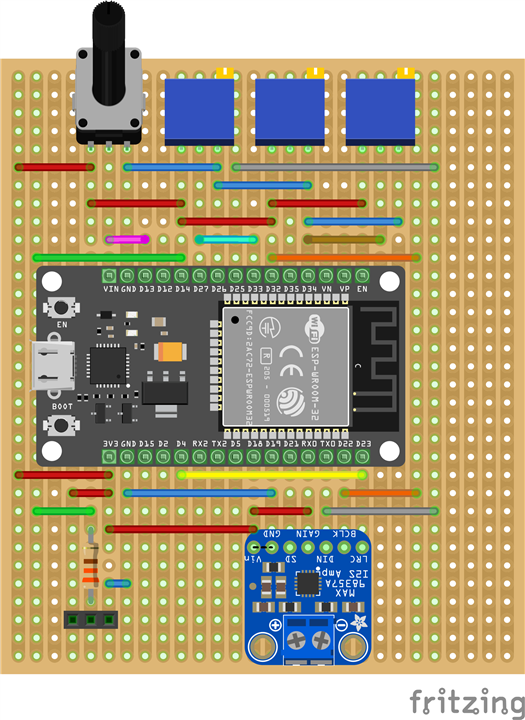

The LED output is controlled via a WS2812-compatible LED strip, which can range from 12 to 50 LEDs depending on availability and desired size. Four 10kΩ potentiometers are used to adjust the setup: one for brightness (marked with an 'X' for easier access), one to set the number of LEDs, one to control the sweep speed, and one to set the length of the light "tail" left behind during animation. A single 330Ω resistor is included in the circuit, and the assembly is built on a breadboard with standard wiring.
Browser-Based Programming and Setup
Programming the ESP32 is straightforward. The firmware can be installed directly via a web browser interface, avoiding the need for a traditional Arduino IDE setup. Once connected via USB, the board can be flashed using Chrome or Edge. The Arduino sketch provided below supports real-time configuration through the potentiometers, making fine-tuning immediate and easy without needing to recompile or reflash the firmware.

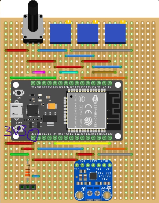

    Looks like there is also an audio volume setting in the code:

    "...Attaching it to the GND did make it louder.  It's not like a KISS concert but louder than what it was before..."
    Looks like you get another 3dB yet if you connect to GND via a 100k resistor.

    Attaching it to the GND did make it louder.  It's not like a KISS concert but louder than what it was before.  I see the resources with the sound files in it.  Could you direct me to a site that will teach me a little about combining two json files

    "...So if I understand your Table 8.  If I connect/route the 3v3 to the gain, I should get a louder volume?..."
    The GAIN pin should already be connected to Vin ( 3V3 ) via the red wire.
    Try disconnecting GAIN from 3V3 to see if you get an improvement; then connect GAIN to GND. Be careful that you don't short GND and Vin together.
    You could perhaps wire in a multipole switch with the common connected to the GAIN pin to allow you to easily select between the various options. You will need 2x 100k resistors.

    I got the sound to work!!!  But yes, it isn't that loud.  So if I understand your Table 8.  If I connect/route the 3v3 to the gain, I should get a louder volume?
