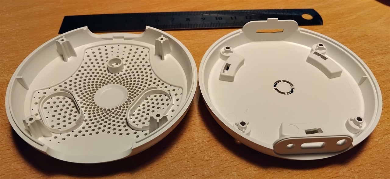

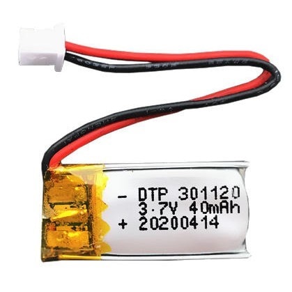

Hello Experts,
I am looking for a kind of adhesive or glue which can bind a tiny Li+ion battery to a hard plastic ABS enclosure's bottom.
Could you suggest a good adhesive or glue for my goal?  Here are my Li+ion battery and my hard plastic (ABS) enclosure.
Thanks for your attention and opinions.Relaxed

    Ideally you wouldn't use glue, but double sided foam adhesive tape or similar. This reduces the chance of damaging the pouch, especially as the cell can swell throughout its life and needs some ability…

    +1 on hot glue (you can easily remove the glue simply by dripping some alcohol on in and peeling it off in case you need to remove the battery) or double sided tape (the foamy one, so it can fill the gap…
  • HKPhysicist
    HKPhysicist 10 months ago in reply to strb +1
    Double sided foam tape sounds good. It is cheap, non-corrosive, easy to apply.

    Im a fan of hot glue for these type of projects because hot glue is non destructive. The battery can be removed by heating the glue with a hair dryer.
    For our E14 colleagues without a hair dryer, Ive also used velcro on lipo batteries, even easier to remove than hot glue, but if you change batteries , you need to put velcro on the new one.

    Is that corrosive? It is not funny if the protective skin of the Li+ion battery has holes.

    How about super glue (Cyanoacrylate)?  Is it corrosive?

    I would use "neutral cure" RTV it would take a few hours to go off, and down the line you can get it off with out wrecking things
    0 dougw 10 months ago
    RTV would work, or just use duct tape.

    I find that the foam based 'sticky fixers' tend to fail after a relatively short duration. I've seen lots of components and wiring floating loose inside enclosures where these have been used.
    Some may use better adhesives than others however.
