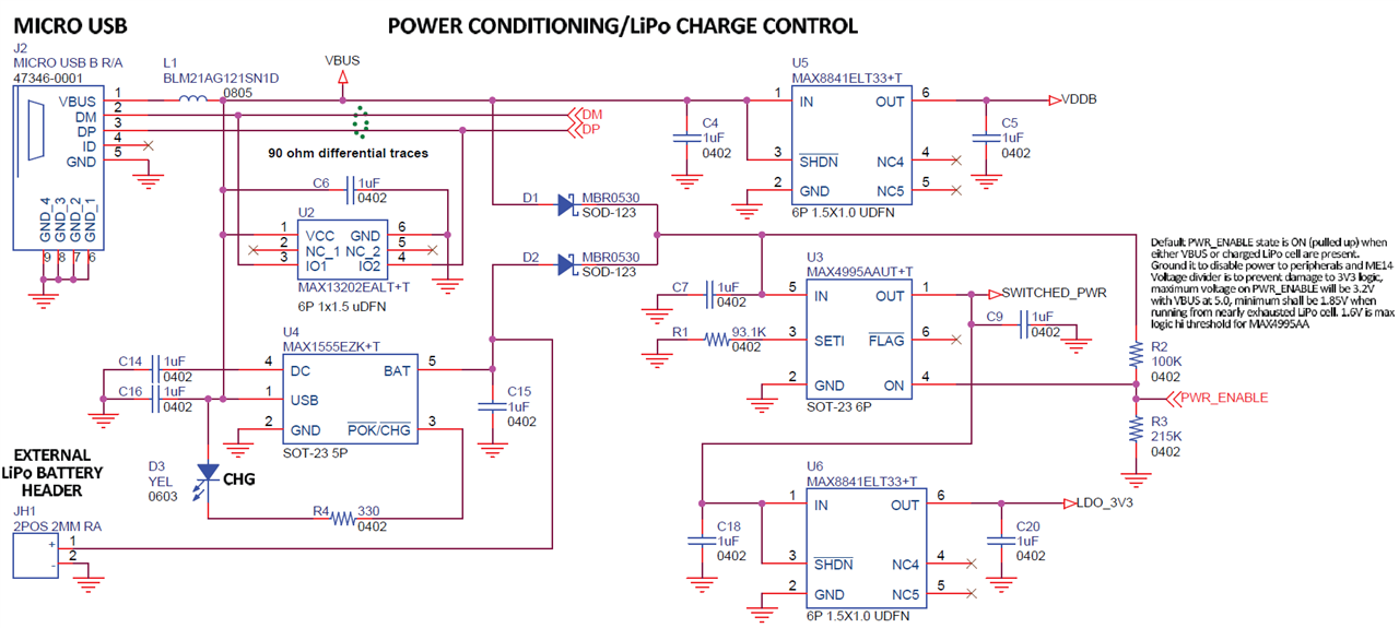

I have a MAX32666FTHR board that embeds a MAX1555 IC to handle charging a LiPo battery, as seen on this diagram:

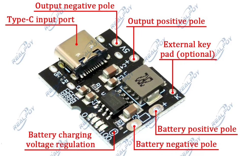

So, to speed up things quite a bit, I'm considering this kind of module:
It's specifications tell me that it can charge a 2A, thus getting around 2.5 to 5 hours charge time. And it is also capable of outputting 5V at 2A, way more than what I need in my project.

At first, I thought about desoldering the VBUS pin on J2 and connecting VBUS to the module output. But this makes the VDDB signal always present which tricks the MAX32666 into thinking it is connected to a USB host when it is not actually so. And I'd really like to be able to continue using the available USB stack implementation in my project.

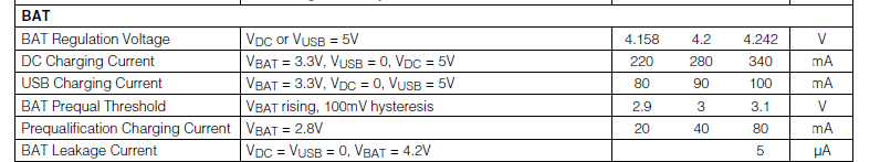

The first is about the survival of the MAX1555 when the battery is under charge by the module. I think it would not mind as it would see 4.2V on its BAT pin, way below the maximum value (7V in the datasheet).
The second is about the survival of the charging chip inside the module when I plug a micro USB cable in J2 on the board. This would put the MAX1555 into charging mode, thus sending 4V into the positive cable of the battery and into the module charging chip, but I believe this should be fine as would be the case in the reverse situation.

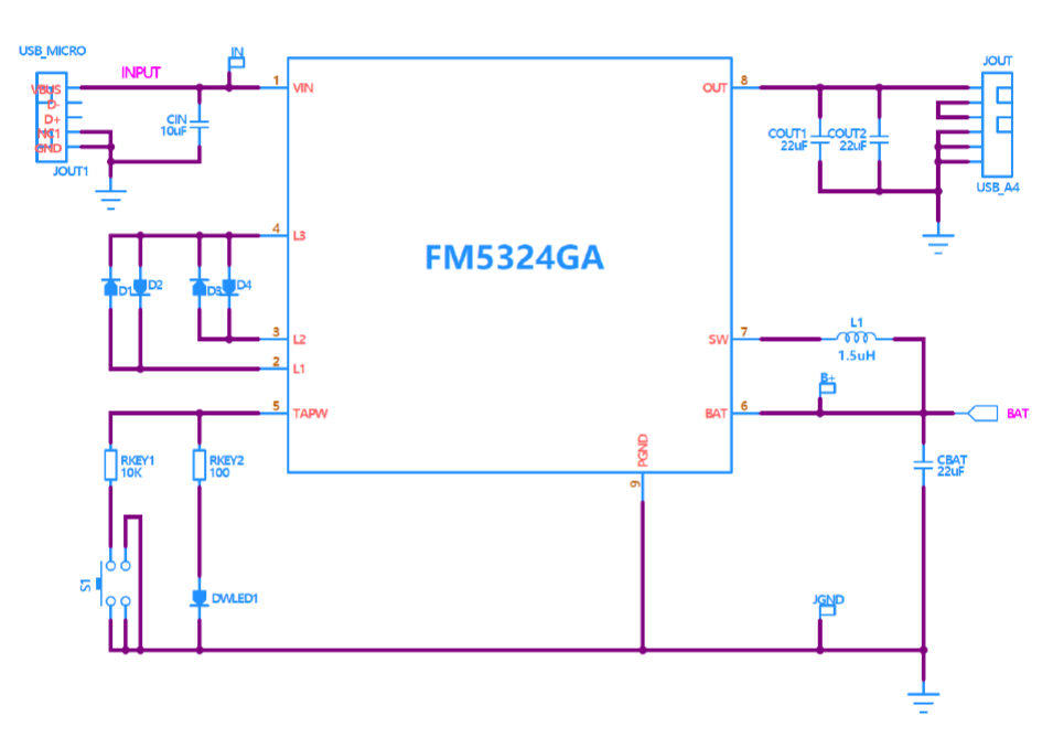

    The board finally arrived and the chip behind all this has the FM5324HJ1 reference on it, which leads to FM5324GA datasheets in Chinese. The typical application diagram is this: Nothing too fancy here…

    Looking at the MAX1555 data sheet suggests that connecting a charger will do no harm (to it).
    The text refers to low leakage current drawn from the battery with no power sources connected and on page 2 of the data sheet you'll find:
    So you can expect a tiny reverse current because the charge should never get the battery over 4.2V. The charger may be upset by the battery suddenly switching from needing 50mA or so at the maintaining voltage at the end of the charge cycle to 1A or more when the LEDs switch on. To cope with this you would need a much more complex system.
    The charging module you plan to use looks like a dodgy ultra low cost Chinese part  - I wouldn't trust it without doing some testing (and not much even then). It may be upset by the unusual load. If its a one off and you have an appetite for an uncertain (but lowish) amount of risk then give it a go. Check carefully what it does over a full charge and discharge cycle with loads etc connected.
    Nothing too fancy here, and after using an online translation service, I see the voltage parameters are very similar to the MAX1555 so I guess everything should be fine.
    And then, if I want to really be on the safe side, I could unsolder the BAT pin on the MAX1555 and slightly lift it from the MAX32666FTHR board so that it never sees the battery voltage and would no be able to interfere.
