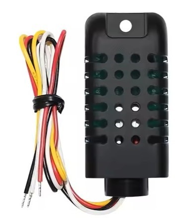

Dear Digital Technology Experts,
I am planning to build a temperature monitor based on a I2C sensor probing hard-to-reach area such as refrigerator interior, ocean terminal container interior, etc.
Then, I have found this cheap China sensor.
Now my question is:
What is the possible maximum length of the probe's flat cable so that I2C data transmission between this temperature probe and the MCU is still kept intact?
Those 4 cables are:
  1. I2C Clock
  2. I2C Data
  3. Voltage input
  4. Ground
Thanks for joining this discussion. Nerd
    Jan Cumps 2 months ago +5
    Flat cables aren't ideal, but if you keep the 2 data lines at the outsides, and keep the wire away from other wires, you may get a reliable meter or 2 at speeds up to 100 kHz. Tricks for longer distances…

    You could do the math and see if your system is compliant to the I2C spec and operational in general. For the rise time of the leading edge of the signals, you need the pull-up strength and capacitance…
    0 Jan Cumps 2 months ago
    Tricks for longer distances: lower speed,  lower pull-up resistors, line drivers (with twisted pair balanced data lines), shielding  ...

    0 dougw 2 months ago
    As Jan indicates, 2 meters should be fine at low speed. If you need to go further check back here for more advice. If 2 meters isn't quite working try with stronger pull-up resistors.
    Note HDMI cables have I2C in the cable, so those lengths can work.
    For the rise time of the leading edge of the signals, you need the pull-up strength and capacitance of the cable (dominant factor) + sensor chip + traces.
    For the level of a driven low signal you need the driver current sink strength and again the pull-up value and rail voltage. With some added margin to account for the noise of the universe, you will know that your system will work.

    I will start to try 1 metre. This length is good enough to probe most refrigerators from outside their cases.
