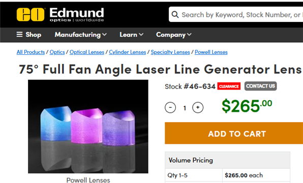

  1. Anyone kno which green laser diode will project a 90 degree pattern parallel to the floor to reveal dust

    rsc 9 months ago +2
    Like this: This is the lens I attach to the Laser module You can also get a laser line level at a hardware store. They use them to put up celling tiles. Some pet stores have small handheld laser…

    any laser diode will do that if you mount lt on a servo to rotate it 90 degrees, parallel close to the floor. Lasers have a narrow beamwidth so they need rotated or using some lens for dispersal or rotation…

    Thanks alot for the info. For you to better understand my intentions, im trying to replicate the laser formation thats on a dyson gen5 detect so i can make my own. Not spending 1000 bucks on a stick vacuum lol

    Where can I purchase items you listed

    Dyson explain how it works here:
    https://www.dyson.co.uk/discover/archive/2021/inside-the-tech-v15-detect
    I expect they have patents which you could find and there is no problem copying for personal use.
    They don't use a mechanical scanner, just a lens - and you may have trouble finding that.
    You can buy the laser cheaply on Ebay (or Aliexpress).
    Be careful - its easy to damage your eyes with these things - don't be tempted to buy a super powerful one !
    You will need to ask on a specialist optics forum to get some help with the lens.

    You’ll want a green line laser instead of a point one. Look for something around 532 nm with a wide fan angle (like 90°),  those are usually used for leveling and should show dust on the floor nicely. Just keep an eye on the power so it’s safe indoors.
