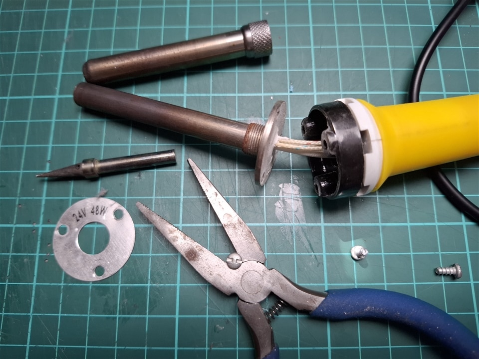

    Looking around for the handle pinout, I stumbled across a picture of of it brand new:
    The cord has a 5 pin DIN connector but I'm not sure which pin is which.
    And to open then handle, I should have needed a "prong" screwdriver but luckily the screw heads were accessible and moved with simple flat pliers.
    But even if I could figure out the pinout, I don't think I even could replace the heating element, it looks like it's potted:
    However, and that's the good news, taking it apart and putting it back together brought it back to life!
    It's now heating up again and not lying about it either.

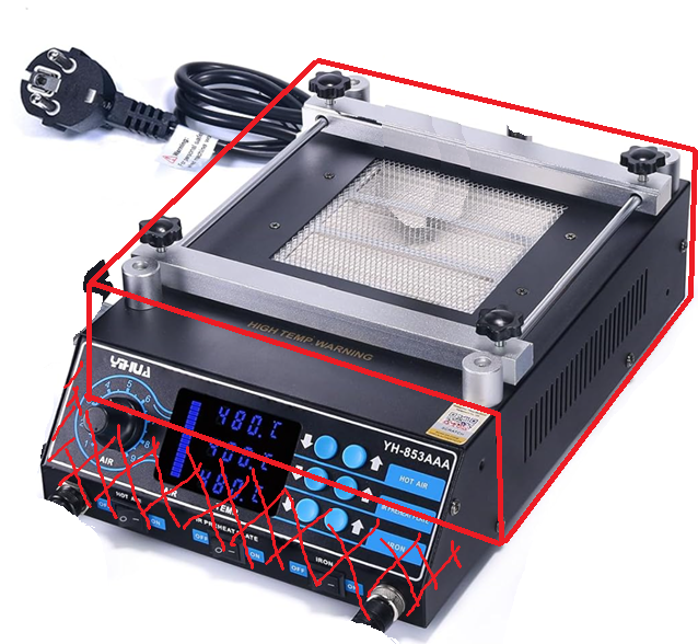

    Hi,
    I bought this soldering station: YIHUA 853AAA
    https://www.amazon.de/dp/B0C4XXBKQM?ref_=ppx_hzsearch_conn_dt_b_fed_asin_title_1
    It works very well.
    And, if you want to build an enclosure with inserts, for this soldering tip you can buy an adapter too:
    https://www.amazon.de/ruthex-L%C3%B6tspitzen-Einschmelzhilfen-L%C3%B6tkolbenspitzen-Gewindeeins%C3%A4tze/dp/B0DP51DDF7?ref_=ast_bl_cpl_dp&th=1
    https://www.amazon.de/stores/page/3ACCBCAE-4D12-47C7-93DB-99763A8BC21B?ingress=2&lp_context_asin=B0DP51DDF7&visitId=4d6fbfc1-5d76-4b22-b57d-776261d5a878&store_ref=bl_ast_dp_brandlogo_sto&ref_=ast_bln

    0 michaelkellett 3 months ago in reply to geralds
    It looks very nice (for the money).
    Have you tried soldering medium sized 0.8mm or 0.5mm pitch BGAs with it ? (up to 500 balls)
    MK
  • obones
    0 obones 3 months ago in reply to geralds
    Woah, that's a whole lot other category here!
    Nice indeed, but definitely not in my skills and price range.

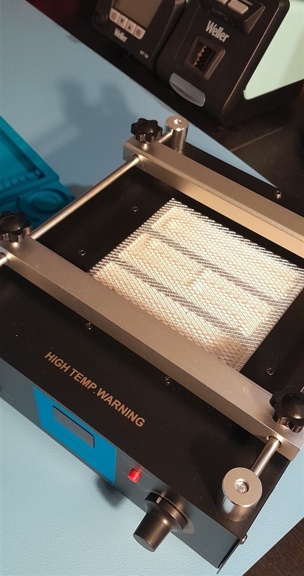

    0 Jan Cumps 3 months ago in reply to geralds
    I have the little version of that YIHUA pre-heater:
    image image
