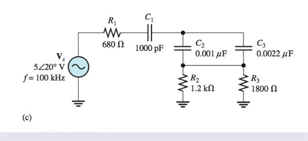

To anyone out there,
I have a circuit for my class and am stumped on the identification of it. I cant figure out weather or not the bottom branches are in parallel or in series. Any thoughts? Any tips or tricks? I know what parallel means but I don't understand the wire that's in-between the resistors and the capacitors. Since the capacitor branch does not end at the same spot as the other capacitor does this mean its not in parallel?

    R2 and R3 are in parallel and are equivalent to 720ohm, and C2 is in parallel with C3 and are equivalent to 2.2nF. This results in a circuit composed of R1 and C1 in series with the 2.2nF capacitor and the 720 ohm resistor, which can also be reduced to one resistor and one capacitor - i leave it up to you to calculate the equivalent resistance and capacitor of the final circuit.

    Hi Mitchel,
    That is your equivalent circuit, taking into account that R2-R3 are in parallel, and C2-C3 are in parellel:

    Raymond,
    When I try to calculate the Parallel resistance I get a weird number. The formula I use it R1R2/R1+R2. This gives me 3600Ohms which does not go with the convention that any resistors in parallel will have an Rtot that is less the smallest resistor. Also if I do the standard formula of 1/1/1.2Kohm+1/1.8Kohm I get 1800 ohms. What formula did you use to get to this?

    For the equivalent resistor I agree with Raimond 720 ohm. For the equivalent capacitor I calculate 3.2nF
  • gihu
    gihu over 9 years ago in reply to salesm21
    R = (1200*1800) / (1200+1800) = 2160000 / 3000 = 720

    First off, you should always use a bit of logic to validate your answers. The equivalent resistance of two resistors in parallel will always be smaller than the smallest of the two resistors, and the equivalent capacitance of two capacitors in parallel will always be greater than the largest of the two. Hope you see the logic in that. The formula you used to calculate the resistances is correct. It is equivalent to (1200 x 1800) / (1200 + 1800) = 2160000/3000 =2160/3 = 720 ohm.

    Gihu,
    Strangely my calculator only comes up with that result if I enter in the 2160000/3000 separately. But I did in the end come up with 720Ohms which sounds better. Thank you

    Maybe it is because you have put directly R1*R2/R1+R2, with no brackets, then result is R2+R2, so 1800+1800=3600, that is a mistake using the calculator, take care on this, because it can frustrate your calculations. I think that in english there is something called BODMAS as a nemothecnic/achromin to refer about the order of the operations.

    All of this is correct.  There is a mantra:  Positive impedances in series sum, negative impedances in shunt sum.
    1.2 K ohm = .833 m seimens.
    1.8 K ohm = .555 m seimens
    .833 m seimens + .555 m seimens = 1.388 m seimens = .72 K ohm
