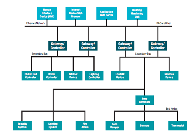

Building automation systems (BAS) are deployed across all levels ranging from small building segments to larger building establishments. BAS is a communication network infrastructure that manages various building services. The key to an effective BAS is having a ubiquitous system that can be deployed to serve new and old building technology as well as small and large commercial facilities. Typically, the complex building automation network of devices includes a primary and secondary bus that is connected to various nodes in the system: Building management service, Building control systems, Zone controllers and end nodes.

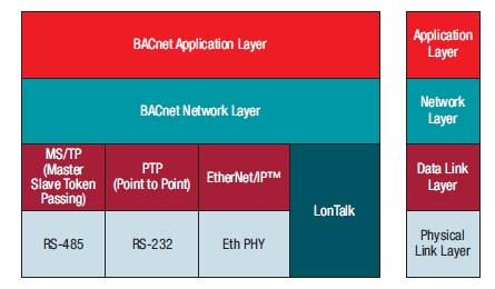

The BACnet protocol institutes a standard way to send and receive messages using wired or wireless standard protocols BACnet data is exchanged between only devices that have BACnet-enabled applications The BACnet standard defines a standard way to communicate via data link/physical layers Ethernet RS-485  RS-232RS-232 and other protocol standards such as ARCNET and LonTalk In addition the BACnet standard also defines a standard way to communicate using UDP IP and HTTP(web services image
Compared to the seven-layer OSI model, BACnet implements a four-layer collapsed architecture. It consists of following layers:
  • Application layer that provides communication services
  • Network layer handles network-to-network communication
  • Data link layer handles device-to-device communication within a network
  • Physical layer converts electrical signals sent over the medium into data
