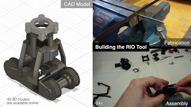

The RIO is a handheld dispenser that allows you to apply different functional tapes of various lengths and patches to most textiles and fabrics. Using the device, you can map out complex circuits, custom-shaped I/O modules, and commodity textile surfaces using a variety of continuous tapes and patches comprised of a heat-activated adhesive.
Built with a pair of wheeled axels used to hold the spool material along with a pair of spring-loaded posts and a soldering iron, the functional tape rolled on spools can be applied directly to the fabric, similar to how you would sketch on fabric using a pen. Pushing down on the spring-loaded iron causes the adhesive to melt and hold the circuit in place. The device is even equipped with a small actuated blade to cut the tape to a specific length for any project. And since the tapes are rolled onto spools, they can be easily inserted and swapped out when needed. All the parts used to make the tool was 3D printed and protected with Teflon heat resistant fiberglass tape.
