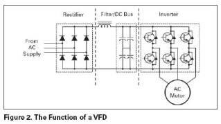

A variable frequency drive (VFD) is a motor control device that protects and controls the speed of an AC induction motor. A VFD can control the speed of the motor during the start and stop cycle, as well as throughout the run cycle. VFDs are also referred to as adjustable frequency drives (AFDs). VFDs are used in applications where omplete speed control is required, energy savings is a goal and custom control is needed.image
VFDs convert input power to adjustable frequency and voltage source for controlling speed of AC induction motors. The frequency of the power applied to an AC motor determines the motor speed.
The VFD's input power comes from the facility power network (typically 480V, 60 Hz AC). It has a rectifier that converts network AC power to DC power. A filter and DC bus work together to smooth the rectified DC power and to provide clean, low ripple DC power to the inverter, which uses DC power from the DC bus and filter to invert an output that resembles sine wave AC power using a pulse width modulation (PWM) technique.
