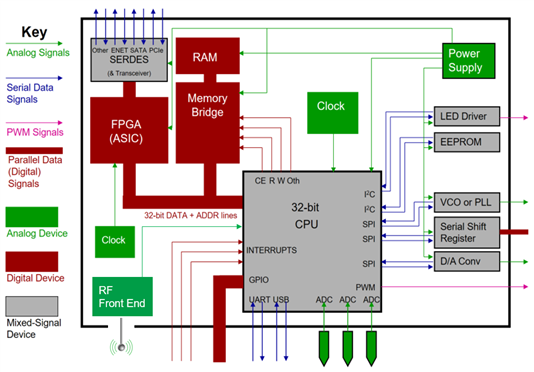

There's already more Internet of Things (IoT) devices deployed than there are humans on Earth. That gap will increase radically in coming years, and the explosion in IoT devices means a commensurate explosion in the need for debugging tools. So what's in an IoT device to debug, anyway?
IoT devices are deeply embedded systems comprising, at a high level, systems-on-chip (SOCs), DDR memory, digital power-management ICs, wireless-connectivity transceivers, and microcontrollers. Data transfers among these subsystems happens through various serial-communications protocols, including UART, I2C, SPI, USB, and PCIe, to name but a few.
Figure 1: IoTs include SOCs, DDR, DPM ICs, wireless, and MCUs
Figure 1 depicts a generic IoT system to give an idea of what one might look like. Signals from analog sensors flow into an MCU and digitized with a 12-bit (or better) ADC. The MCU then uses that digitized data to perform other functions in the system, or it might send the data to the cloud via the wireless transceiver for online computation. The sensor-signal data must be correlated to the controller's actions.
