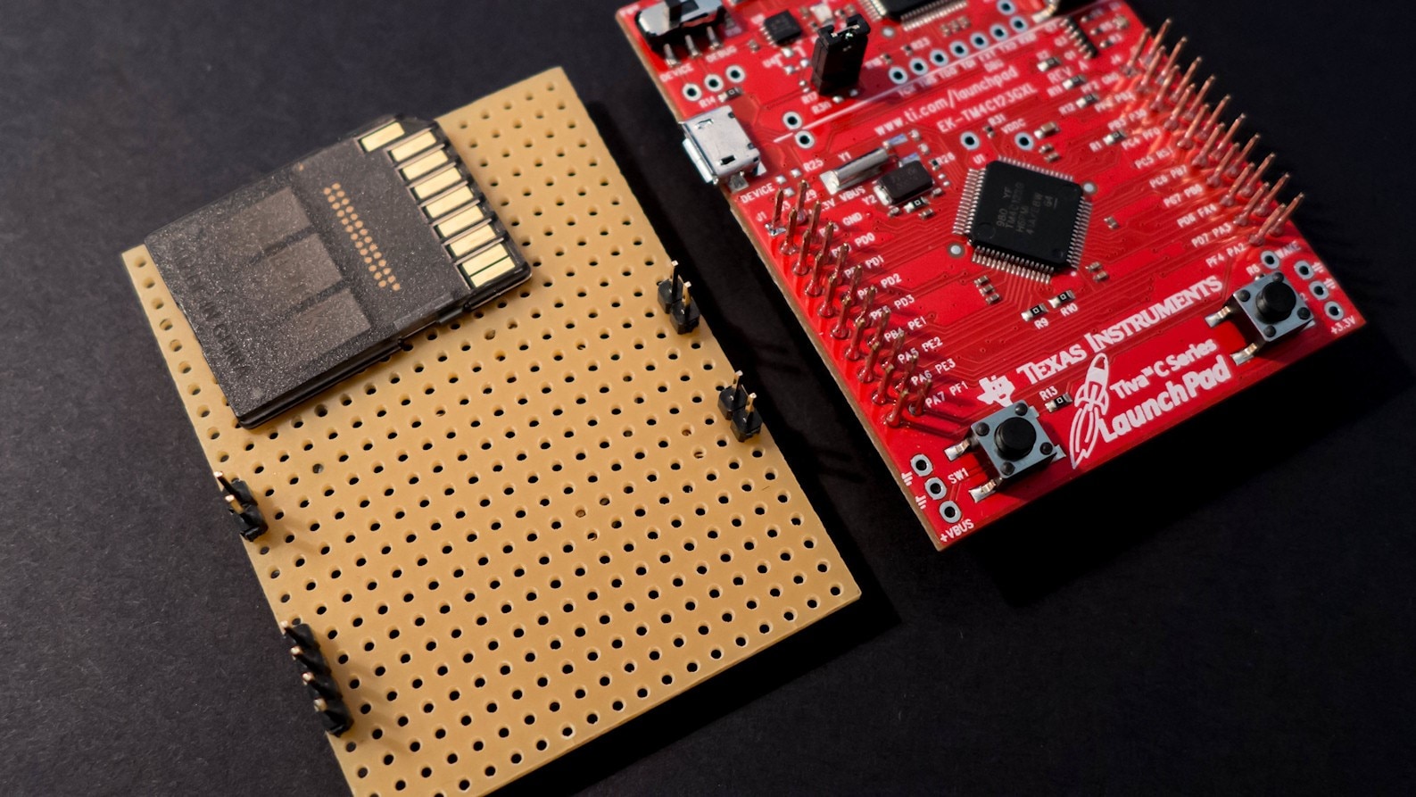

I tested the Swissbit microSD card within an SD card logger project developed a few months ago which has proved reliable for storing thermal images for testing a reflow oven (an in-progress project). The Swissbit card came pre-formatted (FAT format) and worked immediately for the project, just swapping out the full-sized SD card for the microSD card.
If you wish to use the Swissbit cards for data logging projects using TI Tiva boards, the source code is available at the above links. The project uses the cards in SDIO mode and a port of the Arduino SD card library.
Another useful thing for projects could be the ability to verify that the correct microSD card has been inserted, otherwise alert the user, shut down or prevent operation at temperature extremes. One way to do this is to read the ‘Card Identification’ information register inside the microSD card. This contains the manufacturer identifier, product name, serial number and so on. It proved straightforward to do this with a small modification to the SD card library.
