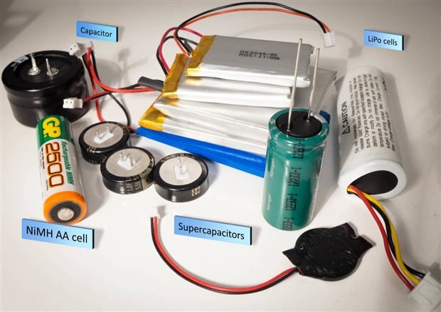

It is useful to know how the product will behave when connected to a battery, and how long it will run for. As the battery discharges, the voltage will drop and power consumption and device performance may change too. The battery performance may permanently reduce over time (for example after hundreds of charge-discharge cycles) and there may be temperature effects as well. Many solutions will make use of solar power or other energy sources, but it is likely that batteries and/or capacitors will be involved in those solutions too.
Testing with real hardware and batteries is important. However, it gets tricky to know the actual state of batteries. A battery simulator could be a good idea for being able to automatically set up an experiment by simulating any battery state (e.g. to start an experiment at 60% discharged state), and being able to repeat tests exactly, without needing to use a real battery. This would be suitable for some tests, before bringing out more expensive commercial simulators/test gear or performing tests with real batteries.

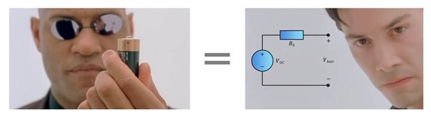

Simulating parts of solutions is a great way to help speed up development of projects (check out Doug's ( dougw ) vehicle simulation system as an example). The project is intended to simulate typical batteries used for IoT projects; it should be able to simulate single or dual AA batteries or a Lithium Ion (Li-Ion) cell at a minimum. In terms of the simulation, it should behave like an ideal voltage source in series with a resistor (this is only an approximate simulation). The equivalent circuit is shown below.
This could be simulated using an adjustable voltage source that is varied depending on load. The amount of variation would also depend on battery type, and the state of the battery (e.g. fully charged or partially charged).
The simulator would continuously monitor the load, adjust the voltage as appropriate and over time adjust the voltage to make Vbatt reduce, to simulate the discharge cycle. It will have network capability so that battery profiles can be uploaded and test results downloaded. A web interface would be useful to aid in use and monitoring of the battery simulator. History of simulations would need to be stored, so that the amount of energy can be decreased to simulate battery charge-discharge cycle ageing.
