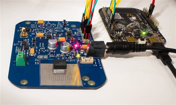

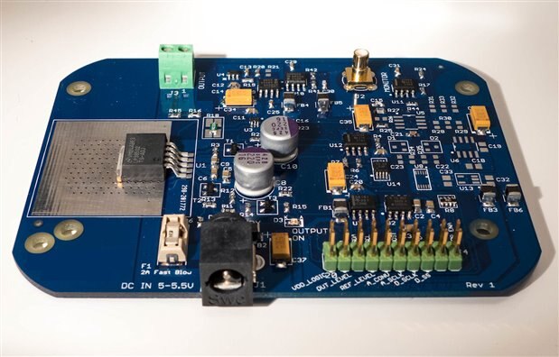

The entire circuit has not been constructed yet (I need to order some bits!). But, until then, some tests can be done to confirm if the rest of the circuit works. The circuit so far was assembled with a soldering iron with the exception of the voltage regulator which was reflow soldered.
Morpheus is controlled by an off-board microcontroller. For these first tests, the weapon of choice was a FRDM board, seen here on the right:
The voltage source portion of Morpheus consists of a 12-bit DAC controlled via SPI (serial peripheral interface). This was connected up to the FRDM board.

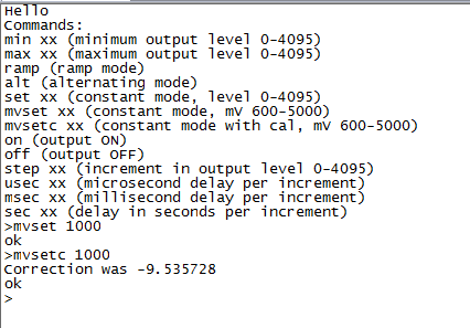

The next step was to implement a small menu system on the FRDM board, so that test commands could be sent to the board on demand via the serial port. Here is a screen capture from a terminal program:
Although this took a couple of hours to code up it saves time in the long run. With the menu system it is possible to send a text command over the serial port from a PC to set any voltage level or to program a pattern (for testing the capability to change voltage rapidly).
The circuit allows for any arbitrary voltage from 0.6V to 5V to be created on demand with 2mV resolution.
The exact output voltage will vary due to part differences and temperature and load (the voltage regulator has 1.5% tolerance at 25 degrees C for the more accurate ‘A-grade’ version but higher across all load and temperature values, and I used the cheaper non-A-grade version), so a reference voltage is fed back to the microcontroller so that it can compute the difference and add or subtract an amount to auto-calibrate when needed. This feature relies on an external ADC, since virtually every microcontroller/single board computer these days has built-in ADC capability. The screenshot above shows the output being set to 1000mV, and the auto-correction of -9.5*2mV = -19mV for a more precise setting. In normal use such accuracy may not be needed (the simulation error compared to a real battery response may be more significant) but it was good to know that a calibration is possible if ever needed (In normal use, the voltage control will be run open-loop, i.e. set-and-forget and hopefully this will be accurate enough for the battery simulation). It was checked with the highest resolution multimeter I had; with the auto-correction feature the output was accurate within 6 mV. I then modified the code to take an average of 64 measurements. The error reduced to 3mV across the range which is probably hitting the accuracy of the microcontroller’s ADC. As mentioned this is more accurate than the simulation is likely to be!
