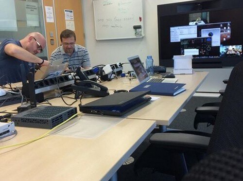

Recently as part of a group at Cisco we had to help decide on inventory for a brand new center.  We wanted to create a more open, rapid prototyping lab.
It’s interesting to know what hardware people use when building out their labs. This post was intended to highlight some decisions we made. Hopefully it can help those who are looking to do a similar thing, or to suggest alternatives.
We wanted a lab that employees, customers and partners would be free to visit as desired, to work on their projects. Another requirement was that the lab should provide access to a lot of diverse technologies that could be useful for the specific verticals we were interested in.
We wanted to be able to allow employees to freely borrow equipment so they can continue development at home.
And we wanted the lab to encourage productivity in a creative yet relaxed environment, so a suitable room was selected with comfy furnishings right outside – very important! And we wanted people to have fun while working.

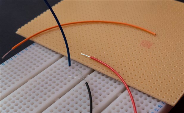

For general prototyping, 10/0.1 wire (i.e. 10 strands of 0.1mm) is about right, and comes in enough colors, so we purchased 11 colors for color-coding purposes (e.g. a data bus for example). If tinned (or gently inserted just twisted), it will fit breadboard easily.
10/0.1mm wire colors:
BlackBlack, BrownBrown, RedRed, OrangeOrange, YellowYellow,
GreenGreen, BlueBlue, PinkPink, PurplePurple, GreyGrey, WhiteWhite

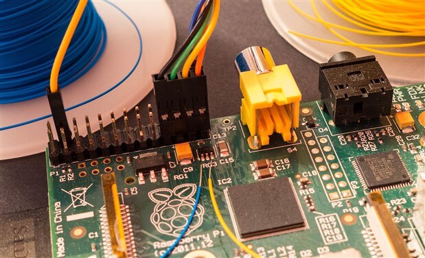

Another wire absolutely of importance with surface mount component prototyping is Kynar wire in 30AWG size. Again, many colors were selected because this wire will be used heavily. You can see the size of it here in comparison to a small component on the Raspberry Pi.
Kynar wire 30AWG:
BlackBlack, RedRed, OrangeOrange, GreenGreen, BlueBlue, WhiteWhite

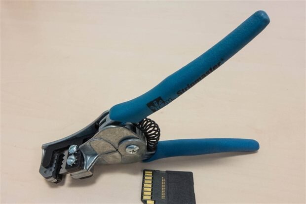

Wire Strippers
We selected the IDEAL 45-672 wire stripperIDEAL 45-672 wire stripper because we'd had some experience with it and it is absolutely great. It is reasonably low cost, and gives a high quality wire strip with absolutely no nicks every time. Bad wire strippers are an irritating thing we didn't want for the lab.
Here is a video of it in operation:
It also works with different wire thicknesses with no adjustment. In terms of price-performance it is unlikely to be beaten. There are cheaper copycat models that look similar on ebay, but it is inadvisable to buy them, because the blades on the IDEAL one press together flush with the needed sub-millimeter accuracy.
There is a higher end version from IDEAL, which would be more suited for production work.

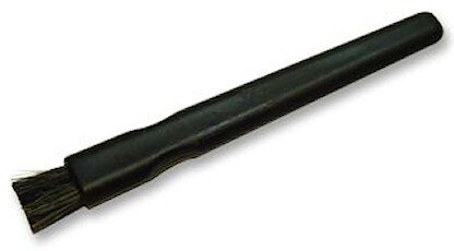

Antistatic Brush
It’s a little thing, but this antistatic brushantistatic brush is quite necessary for scrubbing boards clean.

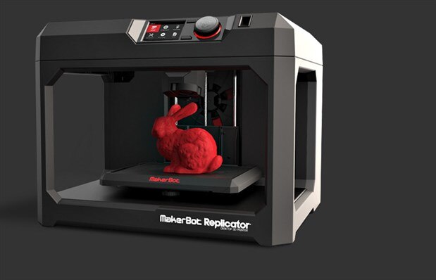

3D Printer
We went with the MakerBot Replicator Desktop 3D Printer (5th Generation Model). There will be more to report when we try it! (Photo from Makerbot site until it arrives)

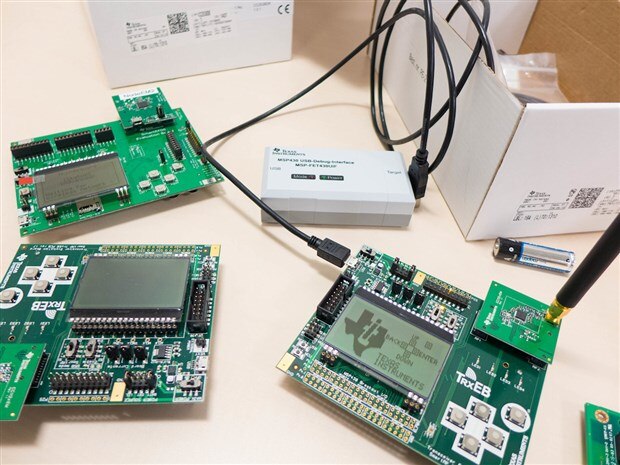

Radio
A _lot_ of wireless, including ISM band, 802.11, 802,.15.4, 3G, GPS modules will be stocked in the lab – several thousand dollars of such wireless boards will be kept for experimentation.
Sensors
The Freescale sensor eval kitFreescale sensor eval kit is a great way of being able to prototype solutions using sensors at low cost, as well as TI’s SensorTagSensorTag. A lot of Freescale and TI sensors were selected to be stocked in the lab.

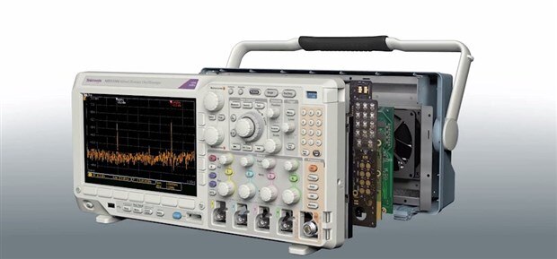

We went for several models of oscilloscopes across a range from the Tektronix TBS1052B TBS1052B up to the MDO3104MDO3104. The TBS1052B will be particularly handy for employees to take home to continue working on their projects. The MDO3104 it is hoped will greatly increase productivity; we’ll soon know.

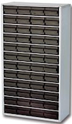

Storage
Raaco cabinetsRaaco cabinets are great. These ones are ESD safe and are robust.

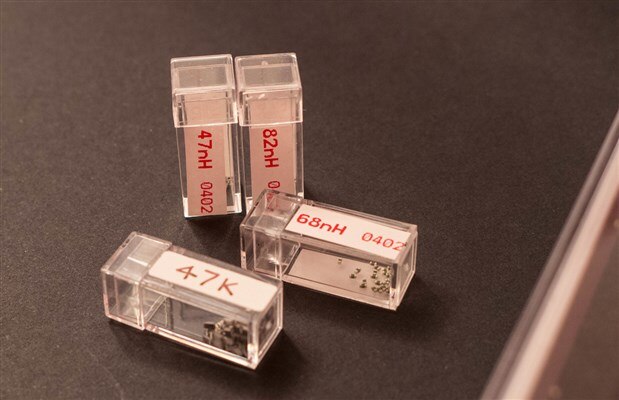

For SMD resistors and capacitors, the Licefa V11-1Licefa V11-1 is the most cost-effective and convenient storage method we’ve found. These containers are tiny, perfect for 0603 sized parts.

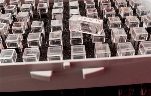

They come in a tray:

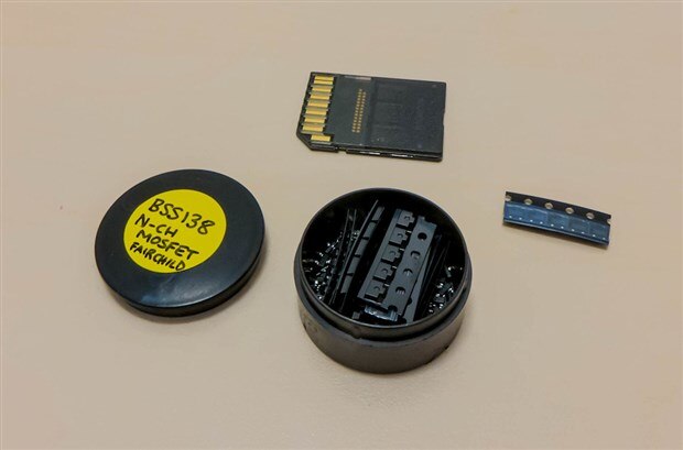

For SMD transistors and diodes, the Licefa A1-1 SMDLicefa A1-1 SMD is perfect. It contains drawers with 250 anti-static round containers as shown here.
Small handwritten or printed self-adhesive permanent labels from a stationary store are required for these storage methods.
