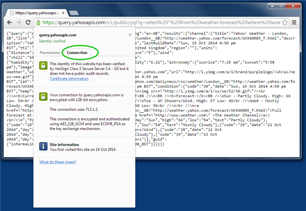

First, access the desired API from a web browser using ‘https://’ to confirm this works, and that a padlock appears to confirm secure communication. In this example, the service provider was Yahoo and the selected service was weather reports using their query.yahooapis.com site.
https://query.yahooapis.com/v1/public/yql?q=select%20*%20from%20weather.forecast%20where%20woeid%20in%20(select%20woeid%20from%20geo.places(1)%20where%20text%3D%22london%2C%20uk%22)&format=json&env=store%3A%2F%2Fdatatables.org%2Falltableswithkeys
The screenshot below shows the response. Clicking on the padlock in the address bar also confirms that the communication is secure (this is using Google Chrome, but other browsers have a similar procedure):
Your PC contains many certificates from various certificate authorities. The aim is to discover which certificate you already own allowed the web browser to successfully establish secure communications with the site in question (query.yahooapis.com).
I couldn’t reliably find a way to do this without using an additional tool. The Certificate Installation Checker from DigiCert proved helpful.
Once this tool is installed, select Tools->Certificate Installation Checker->Check Install and then it is possible to type the site address into it, and it will query the site and list the certificates that it presents. The screenshot below shows what to type and click:
On the last result result, inspect the ‘Issuer’ line as shown above, and also double-click in the white space to bring up more detail. Inspect the ‘Signature algorithm’. The aim will now be to try to match these two fields to a certificate that you already own.
To see the certificates installed on your PC, click on the Windows Start icon and type certmgr.msc to open up the Certificate Manager tool.
Now some manual inspection is needed. Double-click on individual certificates and inspect the ‘Details’ tab to see if the Issuer line fields can be matched up. In the screenshot below it can be seen that for the selected certificate in the Certificate Manager, the Issuer and Signature algorithm details are identical to those found via the DigiCert tool:
The above process has established that you own a certificate that has been issued by the same issuer as the certificate from the query.yahooapis.com site. Both certificates originated from the same Certificate Authority.
Now that there is a high chance this is the correct local certificate, click on Copy to File and select the default format which will be a DER encoded binary X.509 .CER file. This file now needs to be transferred to the CC3200 LaunchPad. This step requires the use of UniFlash which was briefly introduced in Part 1.
