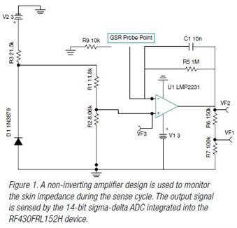

A bio-patch solution based on Texas Instruments RF430FRL152H sensor transponder handles the sensor signal conditioning before processing the data and transmitting it to an adjacent receiver via NFC passive communication. The sensor components consist of a galvanic skin response (GSR) sensor and a thermistor which are in direct contact with the skin. The GSR signal conditioning is carried out using a non-inverting amplifier design. image
The onboard power management on the RF430FRL152H transponder senses whether the device is battery-powered or in proximity of an RF field running at the 13.56MHz NFC resonant frequency. The device is able to inductively couple the RF field and run in a passive mode configuration without the use of a battery since the scavenged RF field provides sufficient power to run the entire solution. In this case, the bio-patch collects sensor data only when in proximity of the RF field.

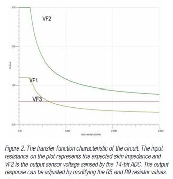

The circuit for the GSR sensor is shown in Figure 1. A non-inverting amplifier design is used to monitor the skin impedance during the sense cycle. The output signal is sensed by the 14-bit sigma-delta analog-to-digital converter (ADC) integrated into the RF430FRL152H device. The impedance of dry skin varies from 1,000 – 100,000 ohms. The transfer function characteristic of the circuit is shown in Figure 2 and is tuned to the expected range.
The input resistance on the plot in Figure 2 represents the expected skin impedance and VF2 is the output sensor voltage sensed by the 14-bit ADC. The output response can be adjusted by modifying the R5 and R9 resistor values.
