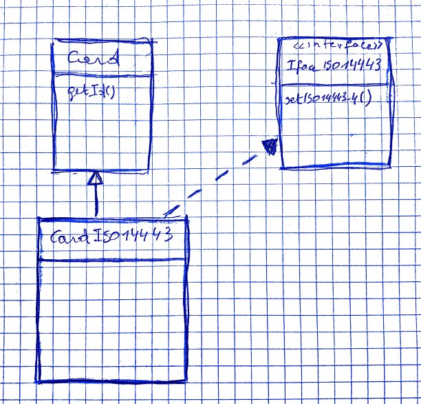

I modeled that in the framework by:

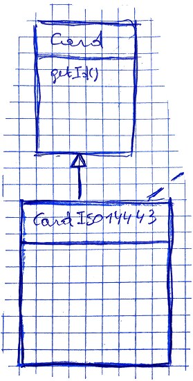

  • Making ISO14443 card class a normal card by default. The class inherits from Card.

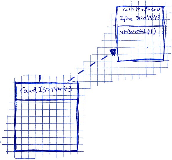

  • I made an interface that defines the ISO14443 behaviour.
  • The ISO14443 card class implements that interface.
You can use the card in code that expects a normal card. It will work.
You can pass it to code that's expecting objects that comply to the ISO14443 interface. That will work too.

class CardISO14443: public Card, public IfaceISO14443 {
public:
  CardISO14443(const Reader *reader, const uint8_t sac,
      const std::array<uint8_t, 10> id, const uint8_t size);
  virtual ~CardISO14443();
  virtual void setISO14443_4() override;
The CardISO14443 inherits from Card. It automatically gets all the behaviour.
It also inherits from the interface IfaceISO14443. There is no behaviour to inherit here because the interface only defines an API. It does not implement anything.
