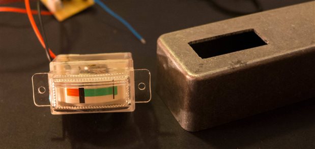

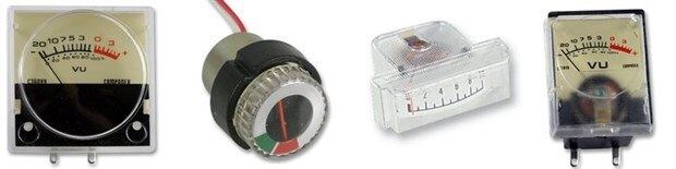

For this design, some nicer parts are used. An analog meter is used to display the measured field. This is far better than an LED for this use-case in my opinion. As you drag the device across a wall, you can easily watch for the peak on an analog meter. I used a random meter from a junk box, but there are lots of options such as an edge mount panel meteredge mount panel meter or my favorite - a round meterround meter - both would work fine.

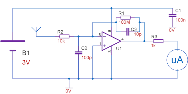

Furthermore, an interesting op amp from Texas Instruments was used for converting the tiny current from the electric field into a measurable quantity. The selected device, LMP7721LMP7721, is ideal for building a transimpedance amplifier to perform the current to voltage conversion.
The circuit diagram is shown below.

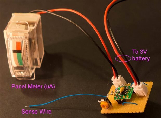

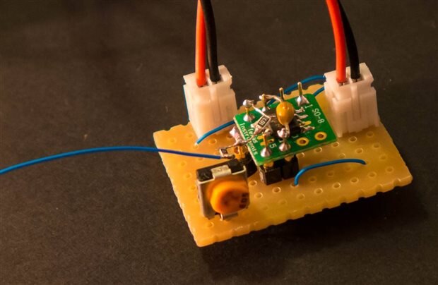

The photo here shows how it was constructed. The orange blob on top of the op amp is an axial 100nF capacitor100nF capacitor C1. The resistor you can see to the left of it is R1.
The op amp is available in an SO8 package, so a small SMD adapter board from TISMD adapter board from TI was used - the adapter board is great value, it comes with the terminal strips too, all ready to solder.
There is a 100 Mohm resistor100 Mohm resistor in the op amp feedback, and it was soldered in the air – the inverting input of the op amp was not soldered to the adapter board, but was carefully bent so that all soldering was in the air. Also, finger contact with the resistor and C2 and C3 was avoided to prevent grease (use tweezers).
Resistor R3 is a small, non-critical value (I used a trimmer resistor but it is not needed). I used a 200uA meter. R3 just provides some protection for the op amp and the meter. In a similar vein, R2 and C2 are an attempt to provide some protection from spikes. I’m not sure how effective it is, these values were not calculated nor tested.
The entire circuit is driven from a non-critical supply voltage of around 3V (I tested with a 3.3V supply). The non-inverting input is at the same voltage as the most negative supply. This is not usually good for an AC input, however it means that no rectifier is needed at the output. It was found the circuit as-is performs well. It is extremely sensitive, from the needle deflection you can sense mains power lines from a foot away (30cm).

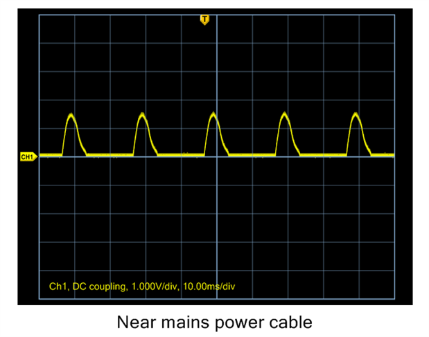

The oscilloscope trace below shows the output when the circuit is held close to the mains supply cable to my desk lamp. It is quite a large output (20msec spaced peaks corresponding to 50Hz mains supply).
