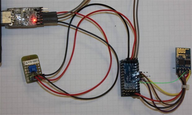

ESP8266 control from a PC via USB-serial
As a first step it is a good idea to check that the module works using RX TX lines from an USB-serial adapter.
  • USB-serial with a CP2102 chip could not supply enough current and I used an external 3.3V LDO regulator on a SD card board that I just had around.
  • ESP8266_RST needs to be connected to 3.3V. It can also be used to reset the module any time.
  • Connection speed is 115200 bps. USBserial transmitting signal went directly to ESP8266, no problem that it has 5V peak.
  • CH_PD is enable pin and should be at VCC.  To reset module pull RST low. To upload new firmware pull GPIO2 low.
Connect to COM port via a serial console like Putty or on Arduino IDE at 115200 and send a command AT. Responce should be OK. Blue onboard LED should blink shortly.
If get responce busy p... you need to pull reset connection low. Better to connect reset to VCC (directly or via  resistor).
ESP8266 happily accepts data at 5 V (datasheet says inputs are 5V tolerant). ESP8266 power supply remains at 3.3 Volts.

ESP8266 + Arduino + Xively upload
  • 5V  from USB-serial is connected  to the 3.3V LDO regulator (LM1117 with blocking capacitors) that supplies both Arduino and ESP8266.
  • I use Arduino Pro.Mini328p without onboard USB because it is possible then  to power Arduino from external 3.3V.
  • Arduino hardware serial is connected to USB-serial adapter for programming and debugging and software serial is connected to ESP8266.
  • ESP_RST should be pulled up. It has to be activated if the module returns busy p...  message.
  • I implemented power down mode by controling  CH-PD pin. See notes about consumption below.
Power consumption
I connected a multimeter in a 3.3V line. While Wi-Fi is working the multimeter is jumping between 25 and 75 mA. When in power-down mode (CH-PD low) current drops to 0.3 mA. This is drawn by the red LED. After removing the red onboard LED, the ESP8266 board current consumption is only 16 uA. That is amazingly low. Arduino current consumption is not measured.
