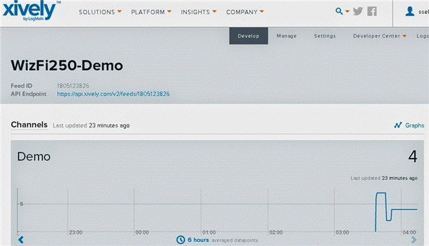

when you see the Feed Channel, you should find a data to apply real time in Xively API server.
https://xively.com/feeds/1805123826
