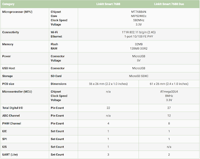

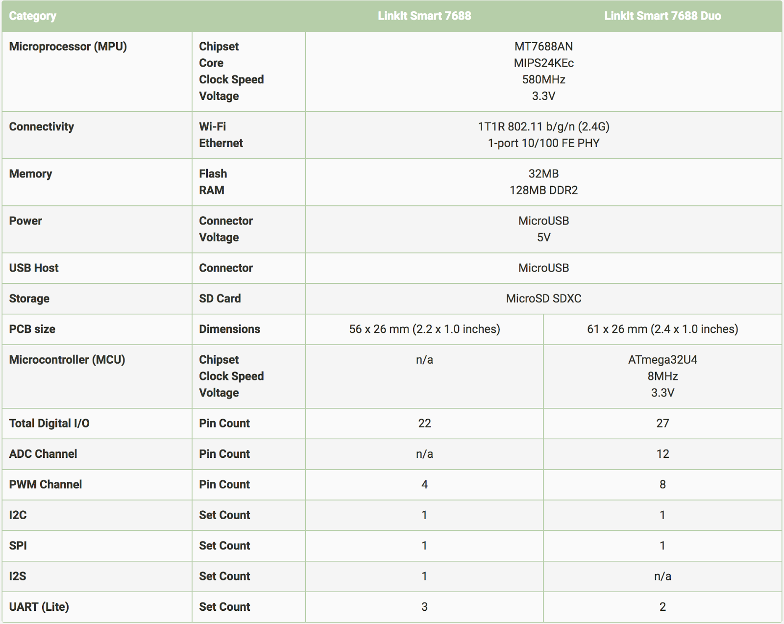

1.  Introduction
     Linkit Smart 788 Duo is a Small development platform based on OpenWRT, i.e. the same tiny footprint linux based OS running on your routers, Arduino Yun (now changed to Linino OS), and many other development platform. Below listed is some technical data for NErDS!!
      So, basically this board is a tiny computer running tiny version of Linux which comes in a tiny box :).

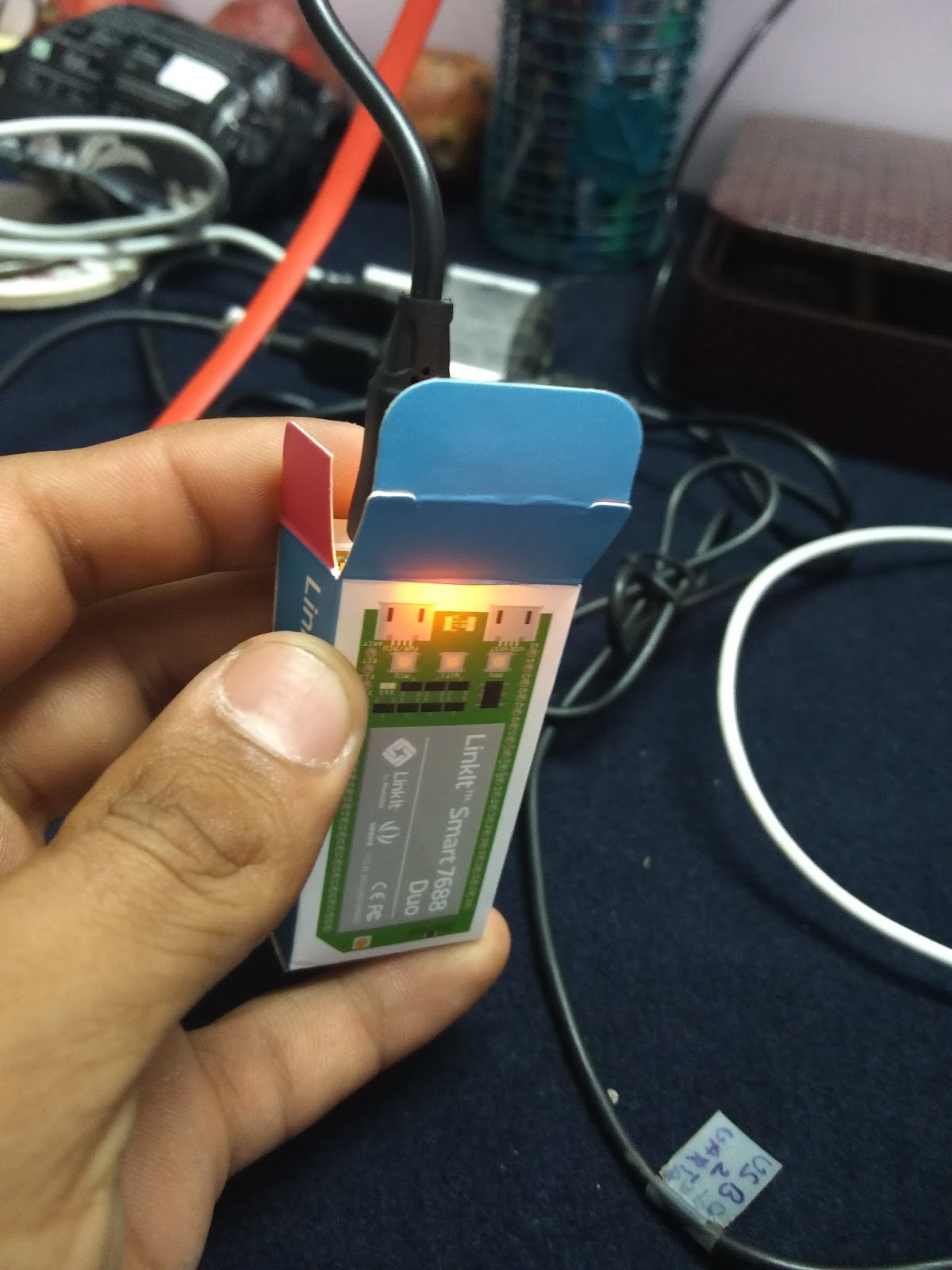

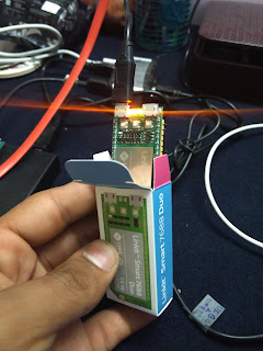

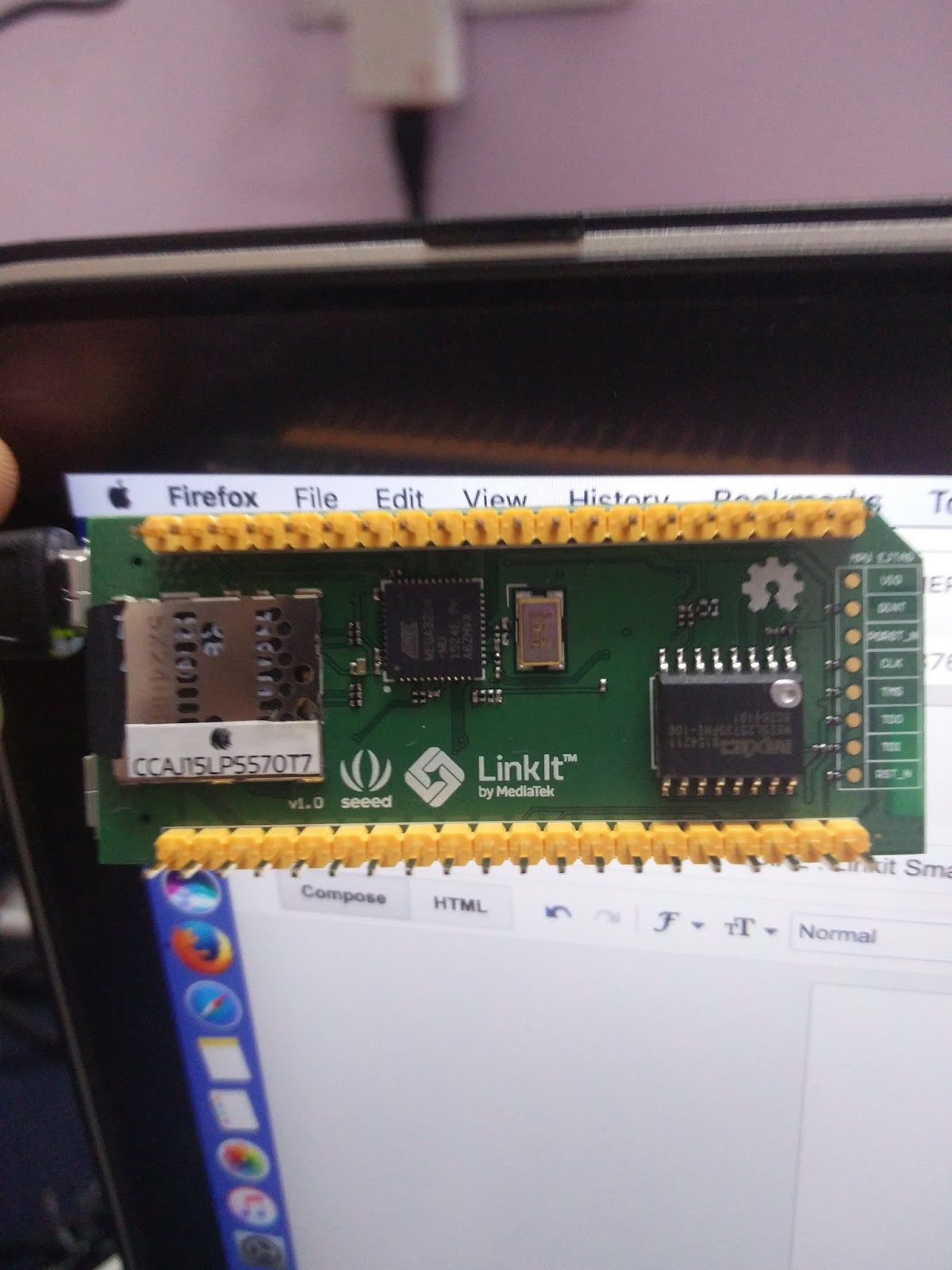

Well next I wanted to get an SD card and mount it on the device; Obviously a 32 MB flash wont even hold anything  image . So we get our mighty 64 GB Memory card laying around and insert it. image That was easy image
Ohh boy,; But how to access the card or the device ?
For now just follow the steps, we will cover the later in detail image
Step1 : Connect Linkit Smart (Left most usb with pwr/mcu label) to power adapter (5v at least 500mA). Ensure green light turning on. The orange light will glow once and then will glow again for about 10 sec before blinking.

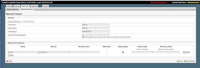

3. CREATING NETWORK SHARES
Well now that we have our base ready, all we have to do is sharing a folder that we can access from anywhere. We will do this using openWRT console.
STEP 1 :  Create a folder to share. Type the following on your terminal
                 cd /root
                 mkdir AirDrive
                 chmod o+rwx /root/AirDrive
                 chown nobody /root/AirDrive/

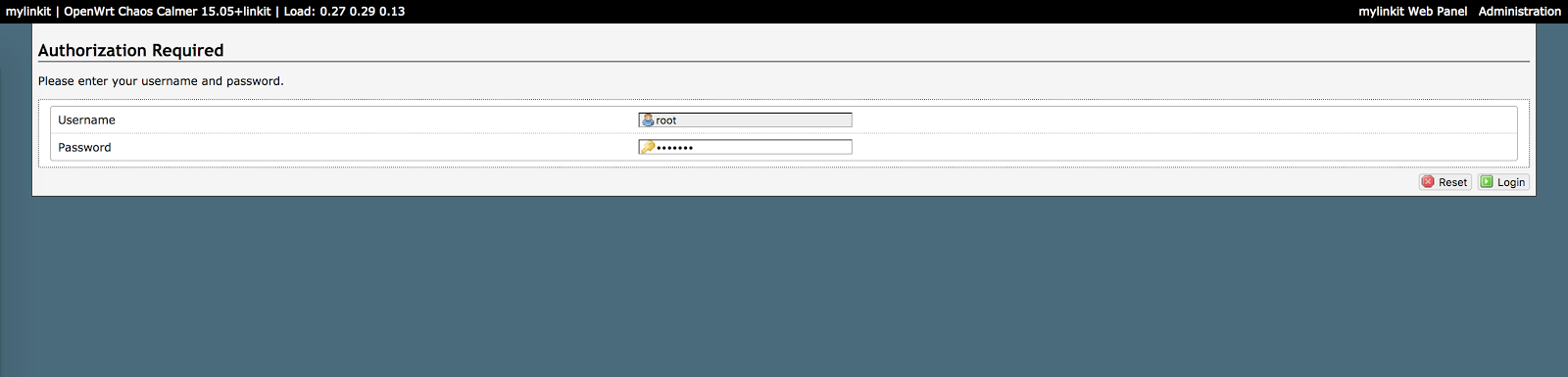

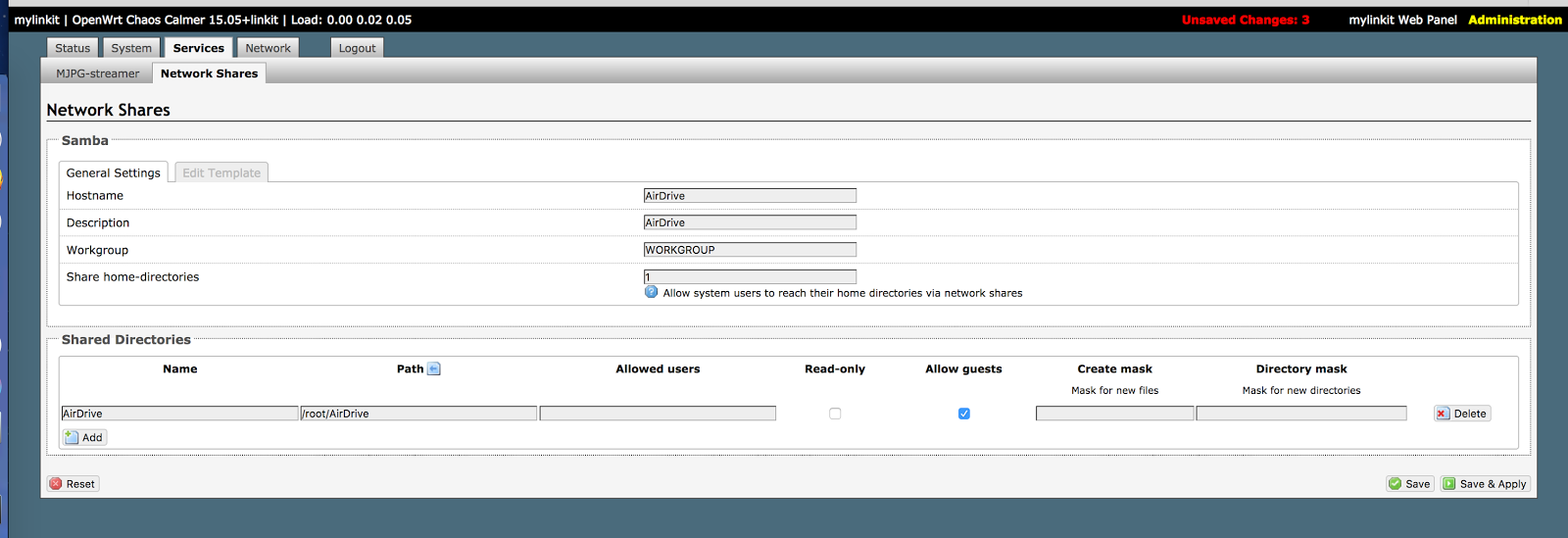

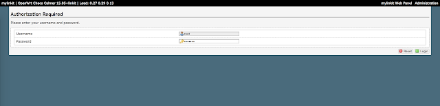

STEP 2 : Open a web browser and type http://mylinkit.local/ ;Clicko Go to OpenWrt
STEP 3 : Login using username root and your password.
STEP 4 : Click on the Services tab.
STEP 5 : Click Network Shares tab. and replicate the contents as given in the image.
Click Save and Apply and you are ready to go :).
STEP 6 : Now Open File Explorer/ Finder  browse to network and you will be able to see "AirDrive". on opening use Guest login and enjoy your own Wireless Pendrive.
