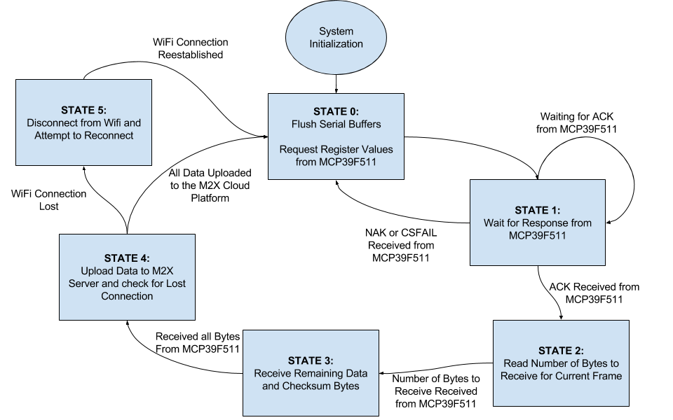

State machine
The system uses a 6 state, state machine of which the last state is a fail case should the WiFi/internet connection be dropped. This case was added after experiencing the issue with the damaged CC3100 in the hope that resetting the connection would resolve the issue. Ultimately this did not resolve the issue with this particular boosterpack but was left in as a preventative measure for other fully functional CC3100 boosterpacks.
The first state is the only state where data is requested from the MCP39F511. In this state the MSP430 sets the address pointer for the MCP39F511 to 0x00 and then requests the next 28 bytes of data. This allows the system to retrieve the values for voltage RMS, line frequency, power factor, current RMS as well as active, reactive and apparent power. Since this request is repeated every 10 seconds an array is used to store this command sequence. This state also sets the green LED high for the duration of requesting data from the MCP39F511 as a visual indicator that the system is working.
The second state looks for an ACK from the MCP39F511. If an ACK is received the state is incremented and the state machine can progress to receiving the number of bytes in the current frame. If there is an issue the MCP39F511 sends back other device responses to indicate the possible issues. The first device response is a NAK, this indicates that the frame was received but the command could not be executed or could not be understood. It is also possible that there was an issue in the command byte. The second possible device response is CSFAIL. In this case the frame again was received but the checksum was incorrect. If either a NAK or CSFAIL are received the state is decremented so that the command can be resent.
The next state (3rd) receives the number of bytes in the frame. This is used in the next state to know how many more bytes need to be received.
The 4th state receives the remaining bytes in the frame. At every iteration through this state the number of bytes received is compared to the number of bytes to be received. Once these numbers are equal the state is incremented. In the current implementation of the software there is no time out or other check to ensure an issue between the MSP430 and the MCP39F511 does not cause the system to hang. There is however a precaution in place to be sure any unread data does not cause ongoing issues by including a Serial.flush at the start of the first state.
The last continually used state is the 5th state which process and sends the retrieved data to the M2X cloud platform. In order to send the data correctly to the cloud the data first needs to be organized correctly. The MCP9F511 returns all data LSB first, therefore the order of the returned bytes needs to be swapped. Before the data can be processed the validity of the received data needs to be checked. To accomplish this the checksum is first calculated and checked. If the received checksum and the locally calculated checksum match then the data is processed. If the checksums do not match, the data is discarded and a new request is issued.
System State Machine with Six States
