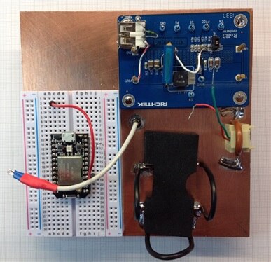

The electronics are mounted on the other side of the coper board, resulting in a neat compact unit.
The Richtek EVB_RT7275GQW Evaluation Board is soldered using some pieces of coper wire.

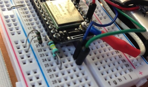

I decided to use the breadboard for the SPARK CORE, so that I easily can make modifications to the circuit.
A RJ-11 connector connects the Weather station to the SPARK CORE.
Isolated coper wires and a piece of foam are used to mount the LiPo battery.
The input and output of the RichTek board are connected to to analog inputs, in order to monitor the Solar panel and power supply voltage.
Voltage dividers converts te max 21V input of the solar pannel to 3.3V which is the max input of the SPARK CORE.
The front and backside of the final unit:
