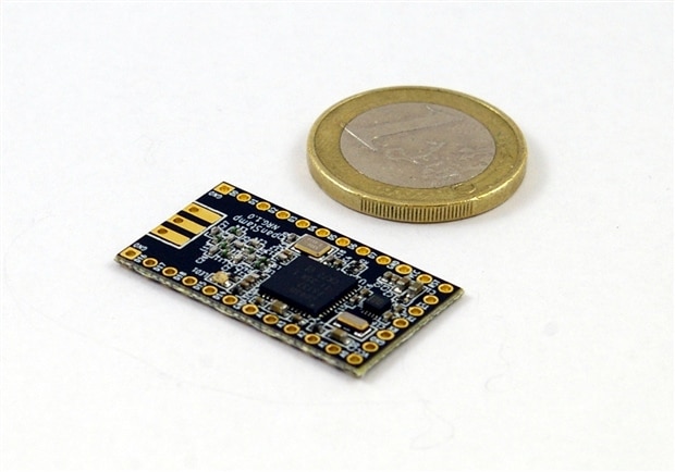

I'm more than happy to announce the release of panStamp NRG, our new Wireless ISM module based on the CC430F5137 MCU and programmable from the Arduino 1.5 IDE.
panStamp NRG is pin, radio and software compatible with our classic AVR modules but entirely relies on a Texas Instruments CC430F5137 MCU instead of our old Atmega + CC1101 approach. As result, we are getting a more robust module providing more features, more speed and consuming less power:

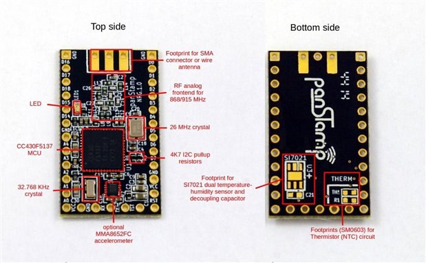

  • Dimmensions: 0.7 x 1.2 in (17.7 x 30.5 mm)
  • MCU: CC430F5137 (MSP430 core + CC11XX radio SOC)
  • Speed: Programmable speed between 8MHz and 24MHz
  • Flash: 32KB
  • RAM: 4KB
  • Info memory: 512 bytes
  • Unique MAC address
  • Voltage range: from 2VDC to 3.6VDC
  • Rx current: 18 mA max
  • Tx current: 36 mA max
  • Sleep current: 1-2 uA
  • Maximum Tx power: +12 dBm
  • RF bands: 868/905/915/918 MHz ISM bands
  • Communication length: 200m in open spaces at 0dBm with pigtail antenna
  • 128-bit AES Security Encryption
  • (Optional) MMA8652FFC 3-axis accelerometer on the top layer
  • (Optional) SI7021 dual temperature – humidity sensor on the bottom layer
  • (Optional) Thermistor on the bottom layer
  • On-board LED
  • Footprint for SMA edge connector
  • Programmable via SBW, serial GDB and wirelessly (SWAP)
