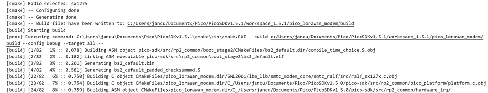

The Semtch LoRa-node lib, that I used with some success in  Test LoRaWan Thing code ported for Raspberry Pico . is deprecated. It's replaced by LoRa Basic Modem.  I'm going to try and port that for the RP2040 controller. I've set ambitious goals:
  • don't change Semtech's code
  • port as specified by LoRa Basics Modem Porting Guide (30 pages of instructions)
  • use CMake, for compatibility with the Pico C/C++ SDK. Unless I find a way to integrate the make files in the build.
  • reusable for other projects

    Jan Cumps over 2 years ago
    First set of sources successfully compiled:
