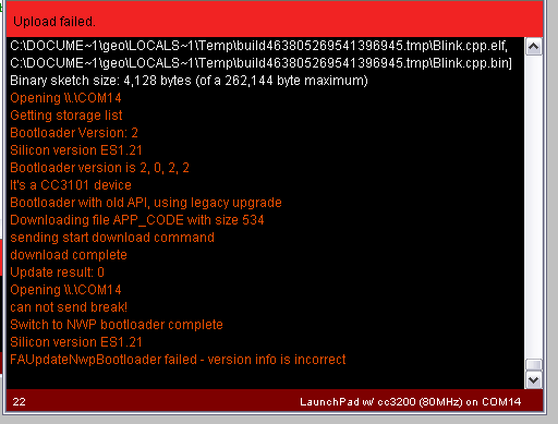

    Next hurdle is Energia, which sees the CS3200, as com14, but won't download the Blink program, it complains as shown below.

    Tried that and Energia gets a bit further but hits another problem which I don't really understand. Hmmmm.

    Yes you have got further but it is crashing because of an old bootloader installed on your cc3200.
    I think I am correct in saying that issues relating to bootloaders are linked to the firmware on the device. You have to upgrade this part manually before use.
    Have to follow the instructions to upload new firmware onto the cc3200 (you need the service pack: SimpleLink Wi-Fi CC3200 Software Development Kit (SDK) - CC3200SDK - TI Software Folder)
    Instructions on what to do are given here: cc3200 hardware guide | Energia
    As said you will need to use Uniflash to upload the servicepack / new firmware onto cc3200. Then you should be good to go with Energia.

    Sadly I think I'm at a dead end. I've just installed the CCS Uniflash, and managed to download Servicepack_1.0.0.1.1.bin into the CS3200LP (see below). It seemed to work fine and verified the code. But going back onto Energia I get precisely the same failure, same bootloader version now as before.
    If you have any ideas I'd appreciate them but I guess I'll have to try to bounce it onto TI. Who will no doubt tell me to use CCS. Which is the only avenue left but it's a bit of a steep learning curve so I'll leave it for another day. I've been two days on this and got nowhere :-(

    I have Bootloader V3 while yours is Bootloader V2.
    Somehow you need to upgrade. Suggest you use the Energia forum for guidance.

    Have now had it confirmed (Energia forum)  that the V2 bootloader is not supported by Energia. So I'll be getting another unit, hopefully it will be to current release levels.
