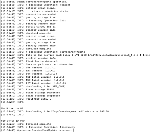

I've spent several hours trying to communicate with the above controller using Energia but without success. I'm really hoping someone will take pity on me and offer some ideas!
The problem I think is with the drivers, or lack of them. I downloaded the driver zip as recommended by Github (EZ430-UART.zip) and unzipped them. If I plug the CC3200 into the USB port Windows tries to install the drivers but when I direct the driver installation wizard to the unzipped files it seems to think they are not relevant and so fails. If I open Device Manager then the CC3200 is showing up as USB<->JTAG/SWD but with a query over it as there are no installed drivers. I wonder if that is telling me something, I would have thought I really needed a COM link not a JTAG link (?). I've tried this on a 32 bit machine and a 64 bit machine - same results.
I have a project waiting to go online using WiFi and this is really frustrating. I get the feeling it's something quite simple but I can't seem to see it. I've checked all the PCB links against the TI User Guide and can't see any problem.

    Have now had it confirmed (Energia forum)  that the V2 bootloader is not supported by Energia. So I'll be getting another unit, hopefully it will be to current release levels.

    BigG over 11 years ago in reply to e14 Contributor
    Here is the screen dump of my cc3200 uploading blink:
    Opening \\.\COM73
    Getting storage list
    Bootloader Version: 3
    Silicon version ES1.32
    Bootloader version is 2, 0, 3, 2
    It's a CC3101 device: PG1.32
    BlockSize is 4096, number of blocks is 64
    erasing 1 blocks starting from  4
    Switch to NWP bootloader complete
    Bootloader version is 2, 0, 3, 4
    BlockSize is 4096, number of blocks is 16
    erasing 12 blocks starting from  0
    erasing file "/sys/mcuimg.bin"
    deleting file "/sys/mcuimg.bin"
    erase file completed
    Downloading file "/sys/mcuimg.bin" with size 4128
    ..Download complete
    I have Bootloader V3 while yours is Bootloader V2.
    Somehow you need to upgrade. Suggest you use the Energia forum for guidance.

    e14 Contributor over 11 years ago in reply to BigG
    Many thanks for getting back, much appreciated.
    Sadly I think I'm at a dead end. I've just installed the CCS Uniflash, and managed to download Servicepack_1.0.0.1.1.bin into the CS3200LP (see below). It seemed to work fine and verified the code. But going back onto Energia I get precisely the same failure, same bootloader version now as before.
    If you have any ideas I'd appreciate them but I guess I'll have to try to bounce it onto TI. Who will no doubt tell me to use CCS. Which is the only avenue left but it's a bit of a steep learning curve so I'll leave it for another day. I've been two days on this and got nowhere :-(
