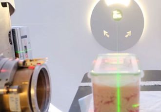

Wearable implants or more precisely ingestible implants are the new way doctors could evaluate a patient’s condition. ReMix: A bucket of animal tissue containing a marker and some tracking implants placed in front of a camera-looking device that will read the signals from the trackers. (Image via MITl)

During testing, Pr. Katabi and the team inserted a marker inside animal tissues and used a device that reflects radiation off the body. That wireless device was recognized for detecting breathing, heart rate, and movement. Next, an algorithm designed to work with the wireless device is used to identify the location the wireless signals are coming from; and consequently, the location of the marker. Since the marker didn’t need to emit wireless signals, it didn’t need an external source of power. However, the team still needed to be careful in identifying the right kind of radiation, since the human skin naturally emits radio signals; some are even 100,000,000 times stronger than the radio signals of the marker. To solve that problem, the team used a diode (a semi conductor device) to separate the interfering signals and create new combinations of radio signals that the team used as a foundation to distinguish between the skin’s radiation and the marker’s radiations.
