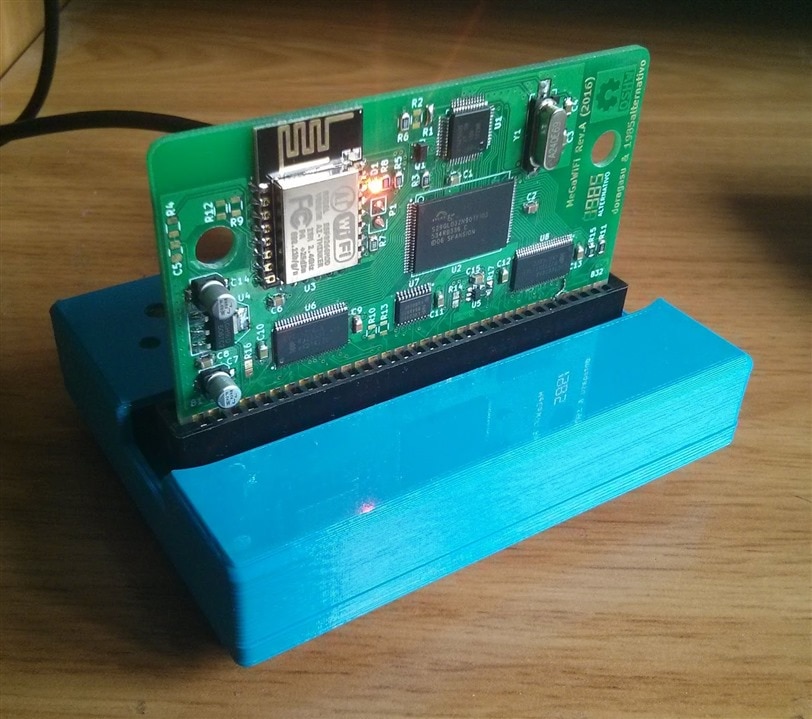

Doragasu’s MegaWifi cartridge placed in a MegaWifi programmer. (Image Credit: doragasu/Kernel Hacks)

One side of the Mega WIFI Addon connects to the Genesis’ cartridge bus so the 68000 CPU can talk to the hardware. For WIFI, Doragasu integrated an ESP8266 wireless module and a UART chip in the cartridge. The UART bridges the Genesis cartridge interface and the ESP8266 serial interface by converting the console’s cartridge commands into serial data that the ESP8266 understands.
The ESP8266 functions like a network co-processor for the console. It doesn’t force the 68000 CPU to implement internet protocols like TCP/IP networking and Wifi communication. Instead, the ESP8266 handles those tasks. The Genesis issues high-level commands while the module does the networking.
Additionally, the creator wrote firmware for the WIFI module and a matching library/command-based API for Genesis developers. With the API, the cartridge becomes usable from 68k code and makes software development easier. Developers call pre-built functions that scan Wifi networks, join access points, open TCP or UDP sockets, perform HTTP or HTTPS requests, sync the system clock using SNTP, or transfer data.
Those requests are then packed into a command containing a payload length, optional data, and an identifier before the ESP8266 firmware receives those results. Afterward, it processes the request and performs the specified task, such as connecting to a server or making an HTTPS request. It then returns the requested data or an error message. Those results are sent back to the Genesis console.
