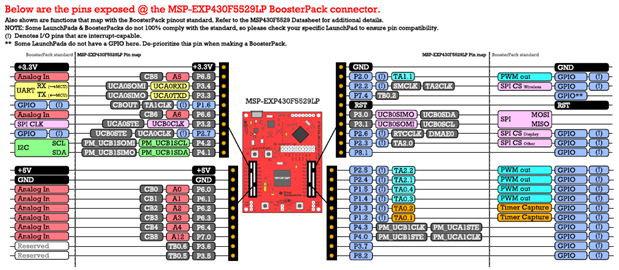

As I have a decent background with TI devices the use of TI products was a natural and convenient choice.The MSP430F5529LP MSP430F5529LP was chosen as the brains behind the system and as previously stated the CC3100  CC3100  was chosen for the Wi-Fi connection. The MSP430F5529LP MSP430F5529LP was chosen do to the wide availability of example code and wide usage of this launchpad with the CC3100CC3100.
Figure 3. MSP430F5529 pin assignment for use with BoosterPacks
The Wi-Fi connection is a CC3100 CC3100 Boosterpack that contains an integrated TCP stack and is interacted via SPI. One of the important features about this BoosterPack is its conformity to the BYOB (build your own board) standards.
Figure 4. Build Your Own Board pin assignment layout
This means that all the pin connections are in predetermined locations allowing for ease of use with other BoosterPacks. The sensor chosen is a MPL3115AMPL3115A pressure sensor from Freescale and was integrated using the Xtrinsic sensor boardXtrinsic sensor board from Element14 and Freescale. Lastly as this needs to be able to work in a remote location I decided to add a local power source, for this the Fuel Tank BoosterPackFuel Tank BoosterPack from Element14 was chosen. This choice however does present its own issue. The Fuel Tank BoosterPackFuel Tank BoosterPack does not conforme to the BYOB standard. With some connections in contention this board was connected via jumper leads and for now only provides power, the power monitoring ability of the BoosterPack has not been implemented but hopefully will be in a later iteration of this project.
