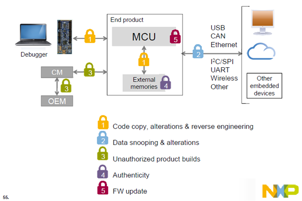

8. The goals of embedded security include:
  • Data Integrity: to prevent data snooping and detect data alterations
  • Code Integrity: prevent code theft; detect code alterations; allowing authorized code changes only
  • Device integrity: protecting cryptographic keys and prevent product counterfeits

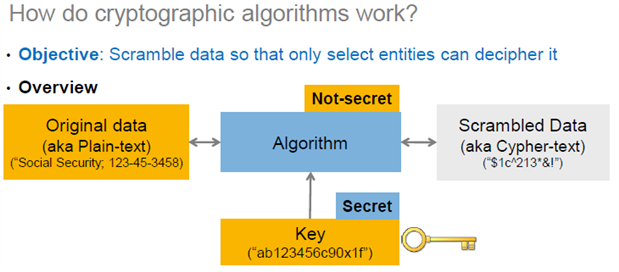

9. The Basics of Cryptographic Algorithms
  • Objective-- scramble data so that only select entities can decipher it
  • Can be implemented in software or hardware
  • Hardware implementations can save performance & power
Source: NXP

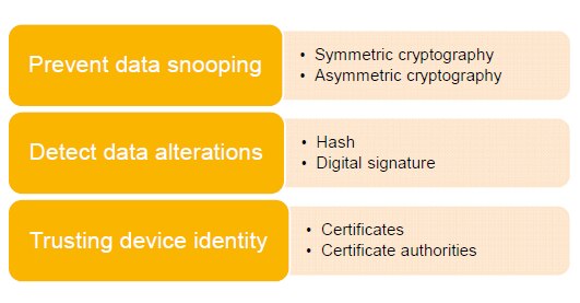

12. Data Security- Components and Solutions
Source: NXP

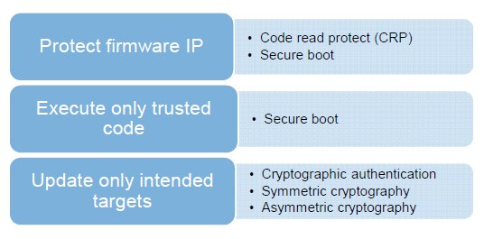

13. Code Integrity - Components and Solutions
Source: NXP

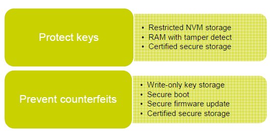

14. Device Integrity - Components and Solutions
Source: NXP

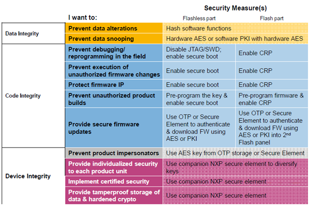

15. Protection Embedded Systems
16. What Security Problem Does My System Have?:
Source: NXP
