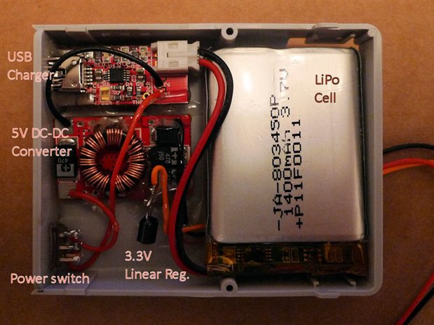

    shabaz over 12 years ago in reply to zengirl2
    Hi Leslie,
    In this size-optimised design, you may most likely need the external charger as Andy says. If you can find space though, it may be possible to permanently leave the charger in the handle, because this means you don't need to find another JST connector (and they can be stiff usually too, and difficult to plug/unplug frequently).
    I've had good experience with this Olimex charger, it is 30x13mm, maybe it might fit?
    The unpopulated pads that you can see in the photo can be used for the output from the battery, to your circuit. I placed a small switch in series at that point, so that the load could be switched off during charge.
    Hi Leslie,
    Thanks! : )
    The diagram below shows how the Olimex module can be used:
    I did a similar circuit topology, to make myself a portable 5V/3.3V power supply (basically just replaced the "Sparkcore" in the diagram above with a DC-DC converter to get 5V and 3.3V outputs.

    zengirl2 over 12 years ago in reply to shabaz
    I was hoping that was the case. So, it looks like you just hard wire the SparkCore and then just plug into USB for recharge. Did you leave an opening in your housing for the USB, or do you just pull your unit out of there for charging?

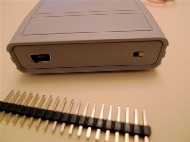

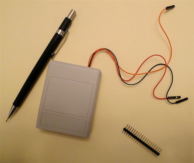

    Hi Leslie,
    I cut out an opening, this is what is looked like end-on:
    This was the completed thing, I had 0V/5V/3.3V wires, that I could plug into any circuit. With the switch turned on, Ithe power would be turned on to the circuit. With the switch turned off, I could charge the unit (actually I could charge the unit with the switch turned on, but I don't think that is a good idea, it may confuse the charging IC).
    If you have room for the Olimex board, I think it could be a convenient way to save having to make the LiPo removable.
    (The olimex board output is just the battery output, i.e. about 3.7V, so if the sparkCore needs 3.3V, then a regulator is needed, the olimex board doesn't contain that).
