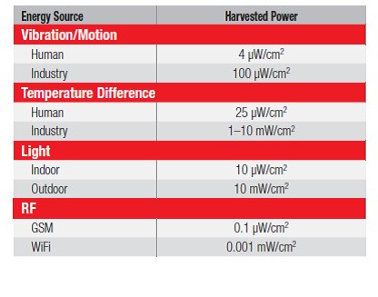

The table below shows the amount of harvested power available from these energy sources with solar (ambient outdoor light) and vibration (such as from industrial machinery) offering a considerable power advantage over the others; keep in mind, however, that not all applications will require that much energy.
Energy-harvesting sources.and harvested power. (Source: Texas Instruments)

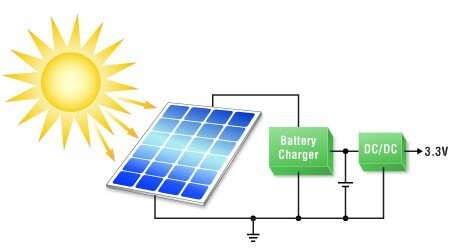

Let the sun shine
One of the most well-established energy harvesting technologies is solar energy, which has been used for many years to power small devices such as wristwatches and more recently to provide back-up emergency power for cellphones. Solar power collects sunlight and converts it into electricity, but light-to-electricity conversion efficiency is not very high; typical solar panels are rated at 15% or 20% efficiency and that’s under optimum conditions; solar panels can endure rain, cloudy skies (reducing output to about 20 to 30% of the current generated in bright sunshine) time of year differences (solar intensity is reduced in winter), changes in the number of hours of available daylight and other factors that negatively impact output.
Semiconductor companies have developed controllers to optimize energy harvesting from solar panels. These controllers utilize Maximum Power Point Tracking (MPPT). This technique optimizes the match between the solar array (PV panels), and the battery bank or utility grid. The function of MPPT has been described as analogous to the transmission in a car. When the transmission is in the wrong gear, the wheels do not receive the maximum possible power. An MPPT algorithm monitors the input current and voltage and controls the duty cycle to maintain the MPP set point needed to maximize energy output from the photovoltaic module. Essentially, a controller IC looks at the output of the panels, compares it to the battery voltage then determines what the best power is that the panel can put out to get the maximum Amps into the battery. Most MPPT's are around 93-97% efficient.
