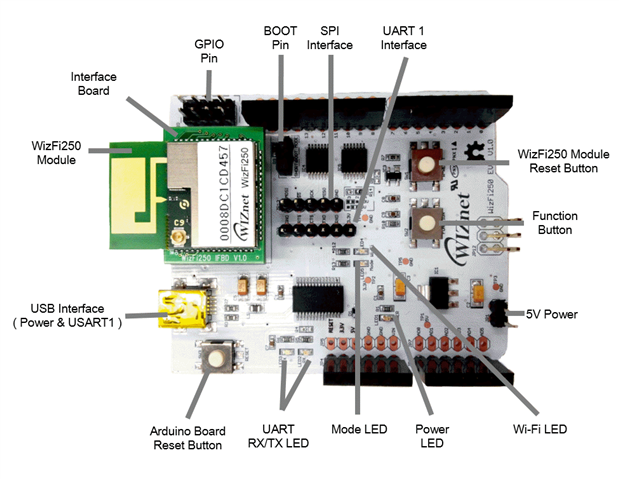

The WizFi250 EVB is the evaluation board for testing WizFi250 and prototyping development. WizFi250 EVB is composed of a WizFi250 evaluation board and a WizFi250 module.
Feature Identification
Button Description
WizFi250 Reset
Through this button, user can restart WizFi250 module.
Function
Through the function button, user can enter specific mode without AT Command.
Diamonds
Factory Recovery : When doing Boot or Reset, press the button over 3.5 seconds
Diamonds
AP Mode : When module is working, press it once.
Diamonds
OTA Mode : When module is working, press it twice.
Diamonds Factory Default : When module is working, press it three times.
Arduino Board Reset
With this button, user can restart Arduino board.
LED Description
UART RX/TX
Indicate UART RX/TX Status
Power LED
Indicate Power On/Off of WizFi250
Mode LED
Indicate Data/Command Mode
Diamonds
LOW(ON) : Data Mode
Diamonds HIGH(OFF) : Command Mode
Wi-Fi LED
Indicate Wi-Fi Association
Diamonds
LOW(ON) : Wi-Fi is associated
Diamonds HIGH(OFF) : Wi-Fi is not associated
Pin Description
BOOT
Enter boot mode
Diamonds
SHORT : Start in boot mode
Diamonds OPEN : Start in application mode
5V Power
Alternative choice for 5V power supply
GPIO Pin
Through this pin, user can use GPIO signal
Interface Description
UART1 Interface
Alternative choice for Serial interface.
SPI Interface
Through these pins, user can control SPI interface.
USB Interface
This provides power supply & Serial interface
Default serial information:
Diamonds
Baud rate : 115200
Diamonds
Data rate : 8
Diamonds
Stop bits : 1
Diamonds
Parity : None
Diamonds Flow control : None
